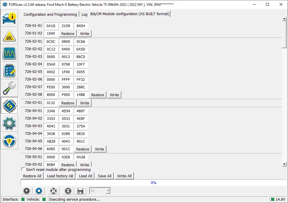

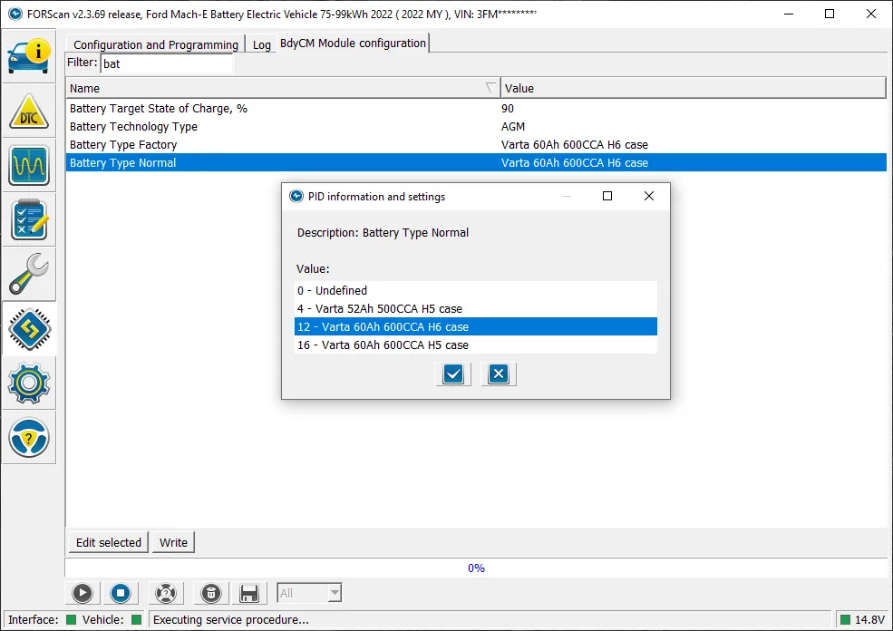

If the vehicle can physically accept a larger H4 battery, I'm surprised someone hasn't found a forscan setting to make the change in vehicle configuration yet.
@Mach-Lee says it will accept an H4 AGM, and Gemini says that Forscan can update the BCM to tell the car it has a 50Ah LN1 (aka H4) AGM.
IMPORTANT: I have NOT verified these values yet. I will check with ForScan and report back. Don't just input random values from an AI LLM into your car until we can confirm these values are correct. This is just a starting point for more research.
The following is my condensed answer from Gemini:
1. Update Battery Capacity (Ah)
  • Open FORScan and go to the Configuration and Programming tab (the wrench icon). Look for BdyCM (Main)—the non-As-Built version.
  • Look for a parameter labeled Battery Target SoC or Battery Type/Capacity.
  • In many Ford BdyCM modules, the 50Ah capacity corresponds to a specific battery type (often labeled as an LN1 50Ah AGM or similar). Select the option that closest matches your new 50Ah rating.
  • If the text-based menu doesn't offer a 50Ah option, you would need to modify the hex values in the BdyCM (As-Built) at address 726-04-01.
    • Default is (H3 35Ah): The first two digits should be 30 (for the 35Ah AGM)
    • For a 50Ah AGM (Group H4 / LN1), change the first two digits to 35
    • Click "Write" on that specific line. FORScan will warn you about a checksum error; click "Yes" to allow it to calculate the new checksum automatically.

You have no idea if that's the correct address, the AI is just guessing and probably pulling data from another forum. As you can see, FORScan doesn't know the correct battery type either since the factory battery is 35 Ah not 60 Ah.
I did say:
IMPORTANT: I have NOT verified this yet. I will check with ForScan and report back.
I will move that to the top of my post.
I am as wary of AI answers as you are. I did verify with the CyanLabs database that `726-04-01` is the correct address for the BMS settings for other Fords, like the F-150 and similar. The actual correct address for our Mach-e is 726-02-01 (for battery type) and 726-02-04 (for Target SoC).
However, I have NOT verified that Gemini is correct about the hex values to change.
Gemini says that the first 2 hex digits are not an Ah value in hex, but rather point to the index in a lookup table of battery types. It also says the default setting is 30, whereas you can clearly see that it is set to 33 in your ForScan screenshot.
Gemini also says that the 1st 2 digits (hexits?) of the last block of `726-04-01` are the target SoC of the 12V battery in hex, with the default value being `50` (in hex which is 80% in decimal), and to change it to `5A` or `5F` for 90% or 95% SoC, respectively. However, you can clearly see in your screenshot that those 2 digits are `4B`, which is at least plausible at 75%, but there is no way to verify that yet.
The upshot is that more research is required before setting values from an LLM in your car, but this is a good starting point for that research.
