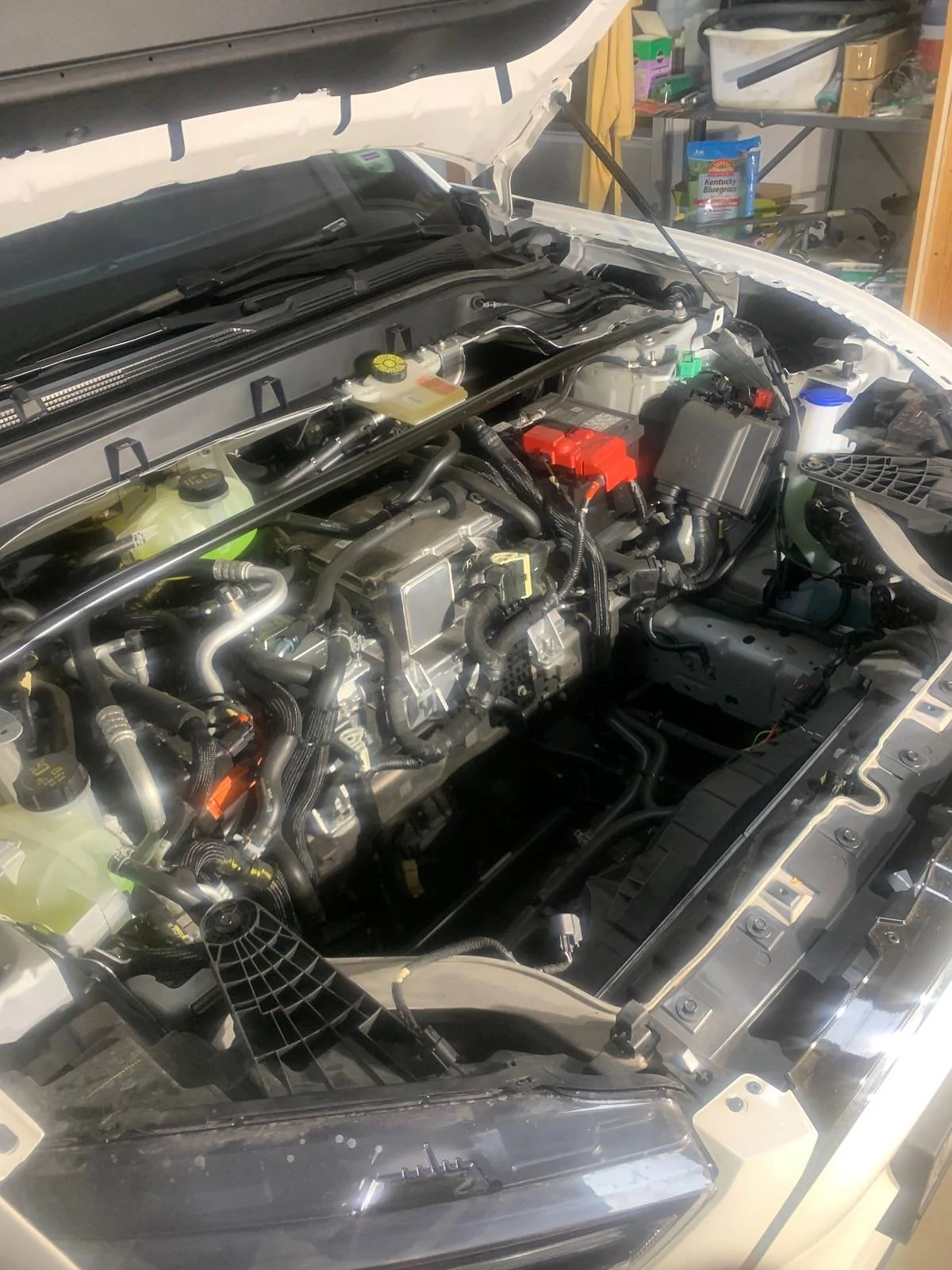

The good news is that the battery monitor was less than $35 and I got to tear apart my MME.

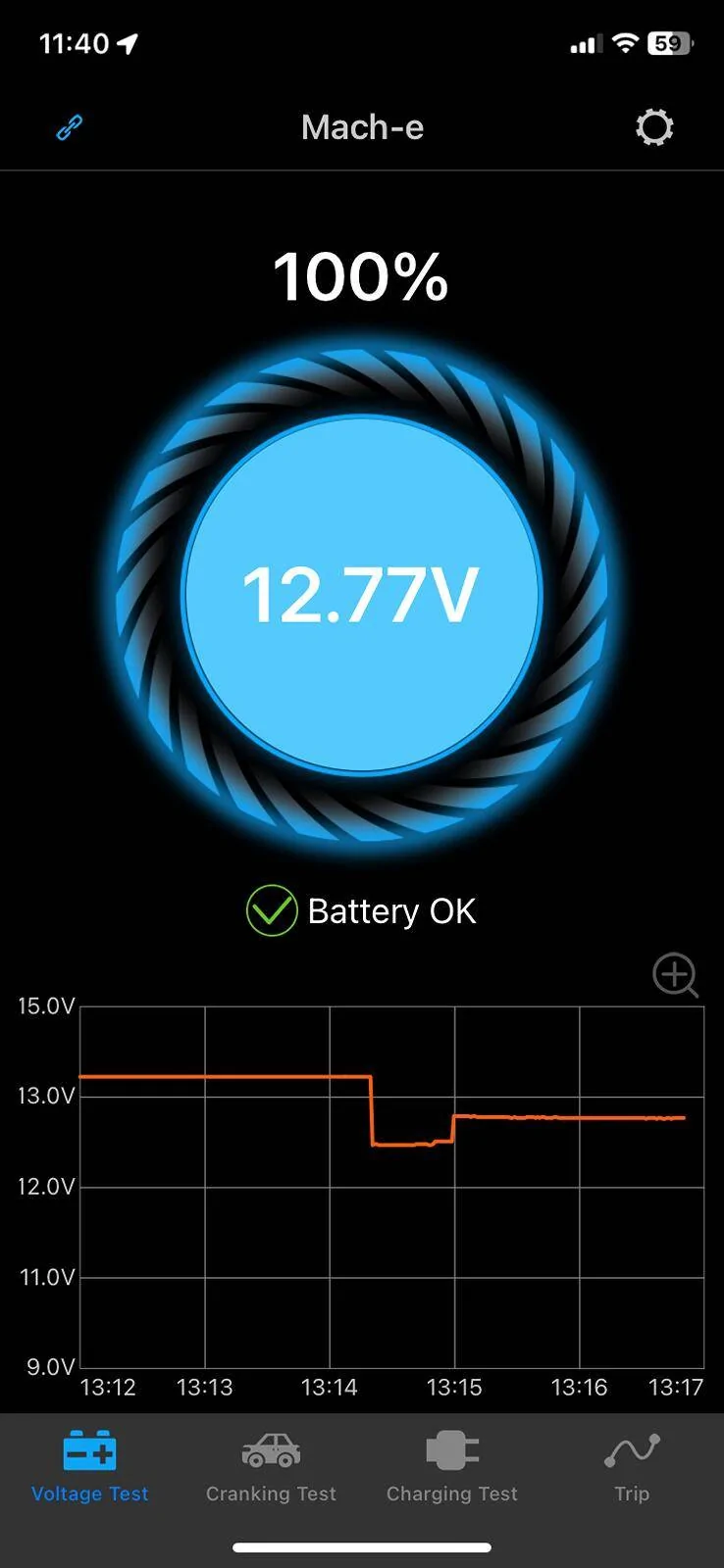

Since the battery monitor was installed the battery voltage has been tracked .
Over the past three days of being parked the battery voltage has steadily dropped by 0.067v per 24hrs from 12.84v on 5/26 to 12.64v on 5/28.
