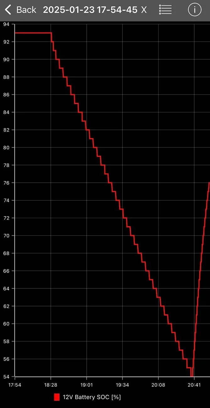

I’m pleased to report that the threshold for automatic 12V recharge has been increased to 55% in the latest BCM software! This is a much-awaited improvement that will ensure the battery remains charged, healthy, and prevents it from running low or freezing in extremely cold conditions.
The original software had a threshold as low as 35%, while later versions gradually increased it to 40%, 45%, and now 55%, which is the ideal threshold.
If you’re unaware, the Mach-E automatically recharges the 12V battery when it reaches a low percentage to prevent it from dying. However, the percentage at which this automatic recharge occurs has changed in subsequent software updates.

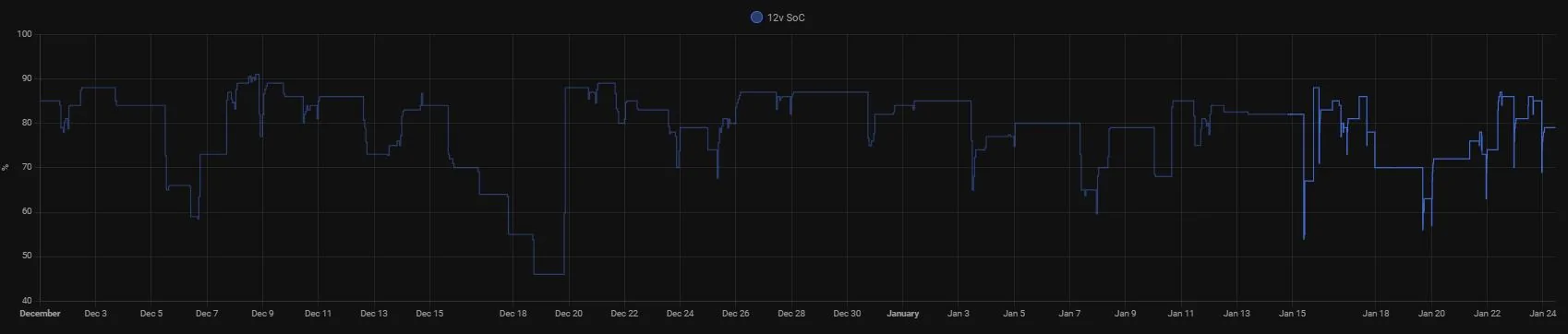

I still have had an instance of my 12v dropping to 47% for a while. But that is the lowest it's gotten logged since December 1st.
how are you logging and displaying this data ?
