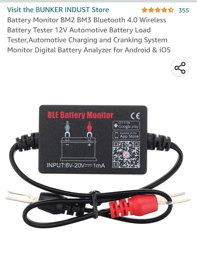

It's a small ~$25 digital voltmeter that is installed permanently on the battery in the car/boat/truck/security gate........
Amazon sells it under multiple listings.
Ford Mustang Mach-E 12V Battery Status Indicator Screenshot_20230419_105615_Amazon Shopping

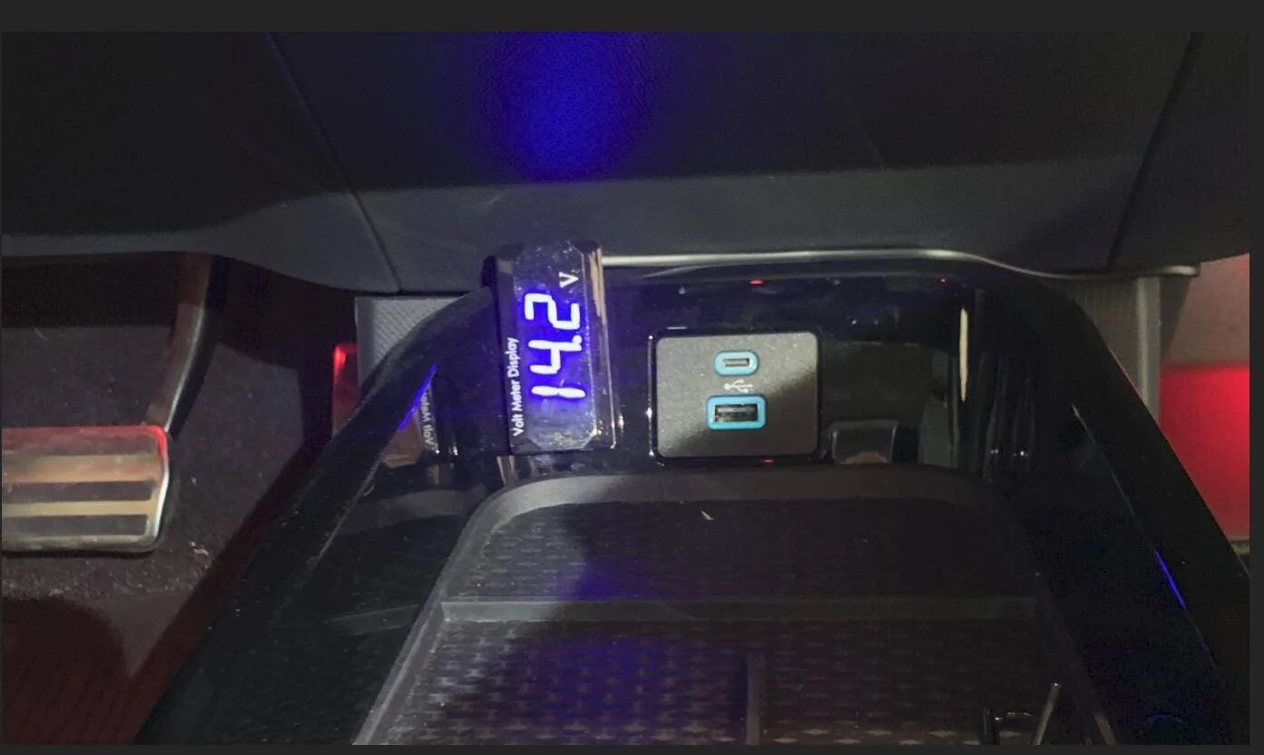

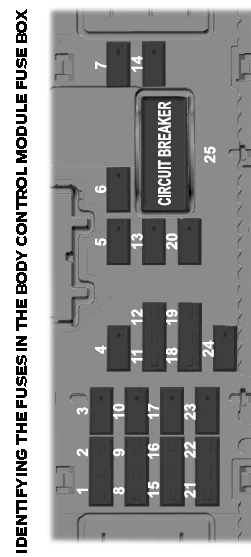

I have read many posts about the LVB and its SOC, which made me do something to easily monitor the battery. I attached an inexpensive digital voltmeter to an unused / switched fuse in the Body Control Module Fuse Box (under the glove box). Either fuse #1 or #2 should work (see Photos below). By choosing one of these locations, the voltmeter will not draw down the battery and will only fucntion when the car is running or on Accy mode. I couldn't find a good mounting spot for the voltmeter where it would be horizontal, so made do with a vertical mount.
Note there are 3 distinct readings to indicate 3 charging states:
12.7 - 12.9 V - fully charged and no significant 12 v drains
13.3 - 13.5 V - Trickle charging
14.2 - 14.8 V - Charging and usually with a significant draw, like fan/AC or headlights.
A fully charged 12 volt battery should read 12.9 V. If you are seeing readings below 12.3 V - your battery isn't being charged or there is at least one dead cell (or both).
The last picture is the voltmeter, with it on Assy mode and just the radio on (maybe headlights).

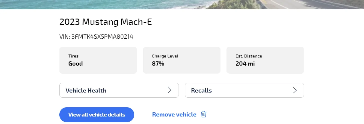

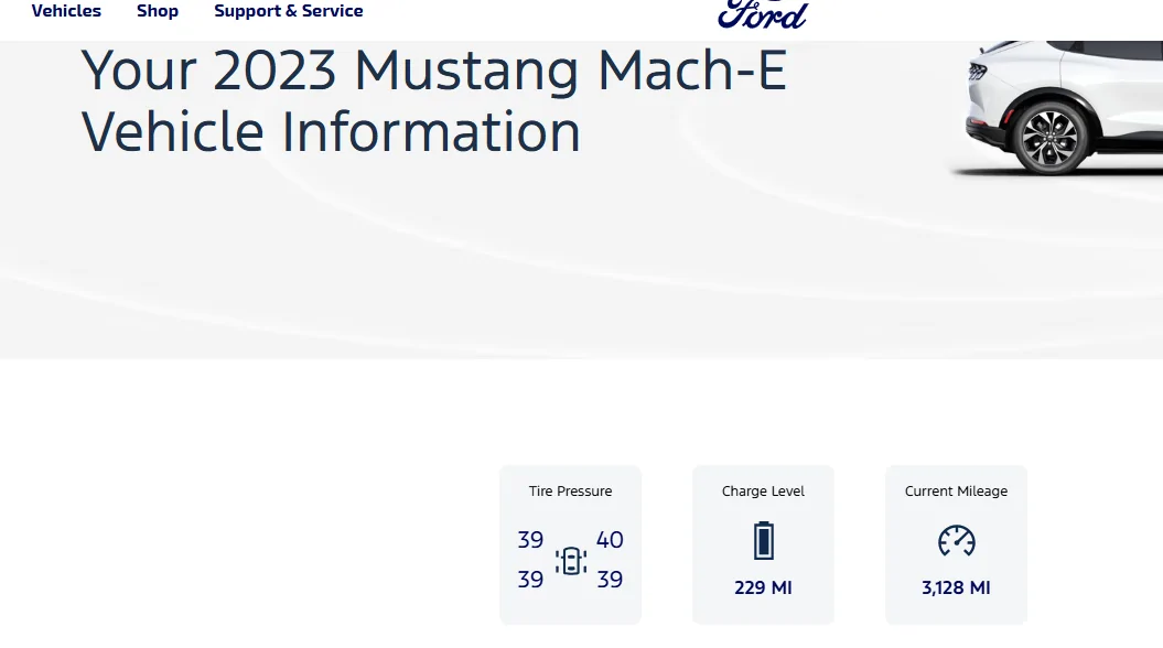

I don't get the 12v status?
You're looking at the wrong page, on ford.com you'll log in then go back up to right upper corner, click on person icon, then ".......account" in my case it's "chris account" that will open up the display and you will see it. You actually clicked on "vehicle dashboard" for the above screen

Got it, thanks. It would make too much sense to have those both on the same page. :angel:

Ford.com Then sign in>account>(yourname)account. The charge level is actually your 12v charge level.
Sorry, when I sign in to my Ford account the icon I see labeled Charge Level shows 181 miles. Same as in the iPhone Ford app. No sign of 12v battery status. Any other pathways, without having to do the full monitoring apps?

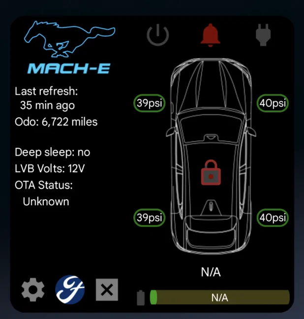

You could also try/use the Ford Status Widget that one of the guys on this forum developed .
It shows 12V battery state
