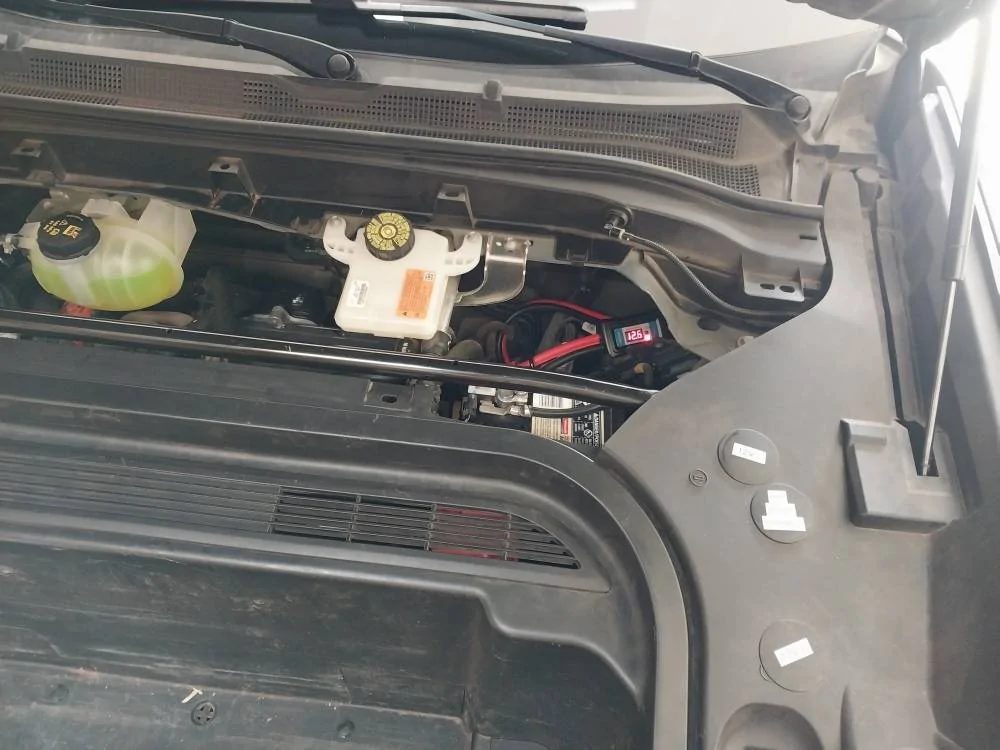

with a wireless BT ODB2 you can't see the voltage when the MME is 'sleeping' because the BT wakes the car up. This is why I picked battery cables that have a built-in voltmeter for my export cables.... sometimes I leave the hood up in the garage, and it's kind interesting to see how fast the 12v voltage drops when the car is OFF, and then drops again if your BT 'wakes it up' on a walk by.
This is why I turn BT off on my phone when I am home... I am in and out of garage many times a day.
