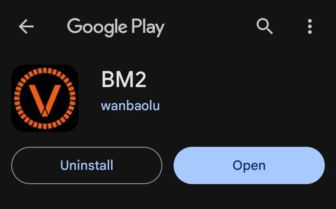

What is the app you are using for the Bluetooth voltometer?
The Bluetooth voltometer comes with an app you download from the Play Store or Apple store.
Ford Mustang Mach-E 12V Battery Status Indicator Screenshot_20240610_121506_Google Play Stor
Really nice app and it can switch between any of the 3 vehicles I have the voltmeters installed on.

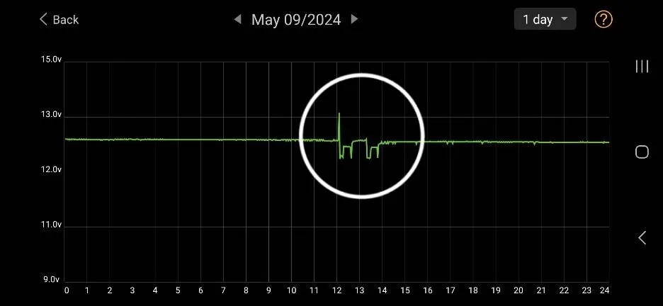

While here (below) are a couple of incidents where someone opened the door on my truck while it was parked in the barn. The first incident, at approximately noon, my brother started the vehicle for Just a moment to reposition it to get something out of the barn. Note the spike in voltage. Evidence that he turned it on and the DC/DC converter (Hybrid alternator) was enabled.
It took about 45 minutes for the AGM battery to settle/recover.
The second incident (~1:15pm) was just a door open or FOB wake up. It too taxed the AGM and it took about 45 minutes to settle/recover.
Ford Mustang Mach-E 12V Battery Status Indicator 20240610_122512

thank you for this information , and speedy reply - much appreciated ! Went to Google Play Store [ as I have an android phone] and there is a multytude selection of " Bluetooth Volt a meter apps to choose from. I am guessing this one =
BM2
[https://play.google.com/store/apps/details?id=com.dc.battery.monitor2]
I don't want to get the wrong one , thank you for your help !!!
just reread your reply , wondering .....do you or don't you need / require a obd bluetooth doggle in the OBS port to made this work as intended? or is it all over bluetooth connection ? and if so is paring hard/complecated ?

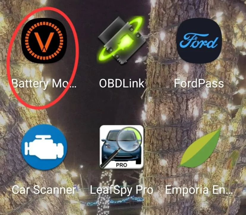

This device is a standalone voltmeter and has no need to communicate with the vehicle OBD interface. Think of it as a handheld multimeter that you clamped to the battery post and left it in the vehicle permanently. Except you can't view its screen because the hood is closed.
The screen is on your smartphone and getting it's value over the Bluetooth built-in to the voltmeter itself.
If you see a lot of apps in the play store, look for the icon:
Ford Mustang Mach-E 12V Battery Status Indicator Screenshot_20240610_135821_Microsoft Launcher

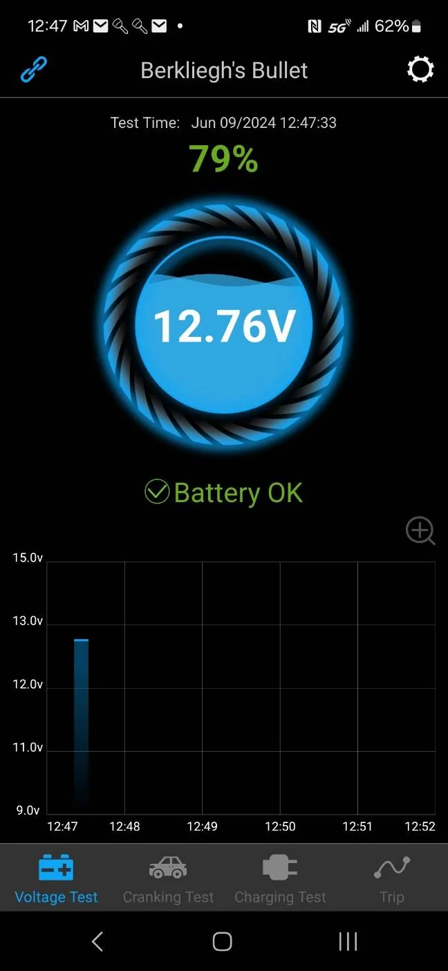

An easy way to monitor its health is with a Bluetooth voltmeter.
I'm sitting in the Lazyboy and I just launched the app on the phone. The car is outside in the parking spot.

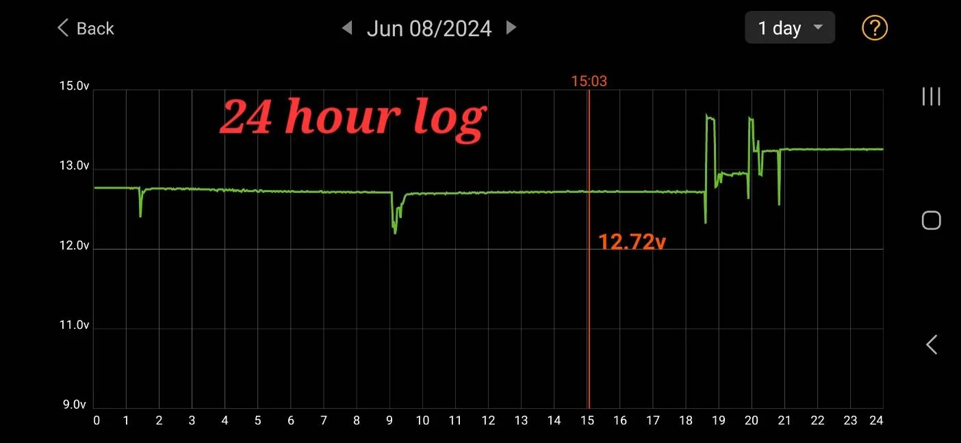

It also logs the voltage and you can view a 24 hour period, or a 7 day period.
Here's yesterday:
What’s nice about it is getting to view static voltage without waking the vehicle and taxing it, thus getting a misleading reading.
voltage give no real indication of 'health'.....
