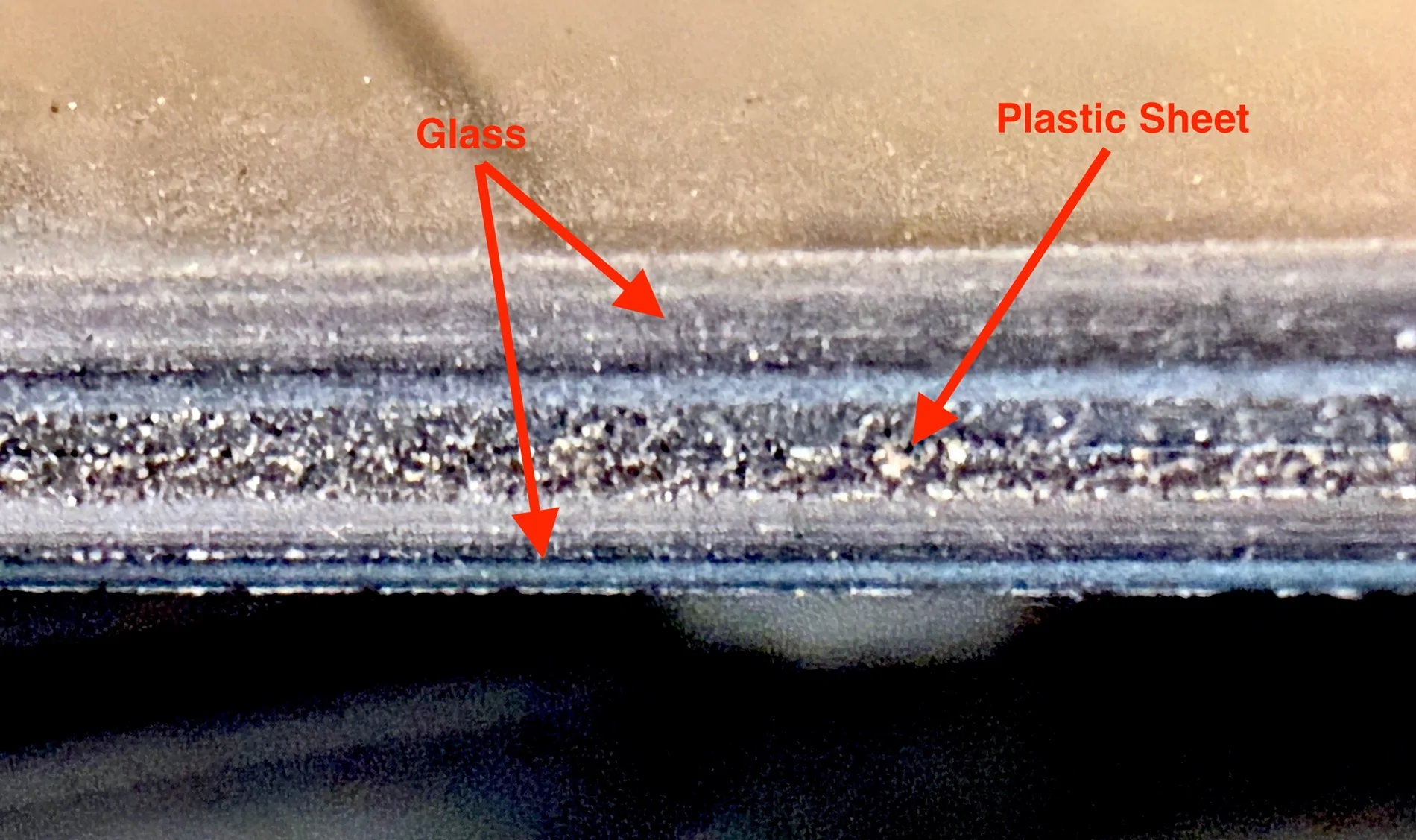

Posted this a couple of years ago but I will mention again. Two things....
The Windshield on the Mach-E is an acoustic "SoundScreen" (as marked in the lower right front corner) which is comprised of a sheet of plastic sandwiched between two thin pieces of glass. Because the glass is not as thick as a standard windshield, it's more susceptible to chipping and cracking. You should replace it with the same windshield because it is dramatically quieter but you do have the option to replace it with a normal one.
Secondly, you can spend $300 and get a windshield protection film applied to the outside. I have done this on the last two Mach-E's, and my GT500. I have a detailer here in town that uses Ceramic Pro products and they make a protective film (8mils thick) that I've been using the last couple of years. My '21 Mach-E had 48K miles when I traded it in and there were a few nicks out of the protective film but the glass was never touched. If I would have kept the car, probably would have gotten the film replaced on the 5th year or so just so I would have a perfectly nick free film again. You should go check out a detailer that sells this product and can demonstrate how durable it is.
This is not a great photo of the edge of the SoundScreen windshield but you get the idea.
