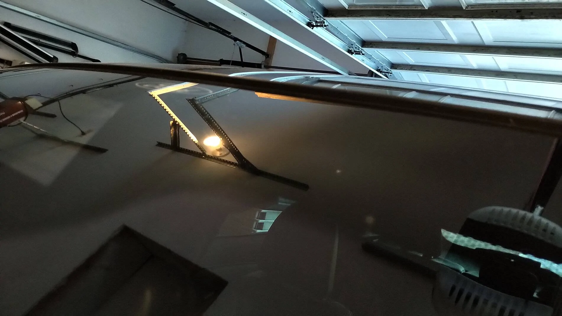

Has anyone heard anything about these fixes resolving the wind noise at the junction of the windshield and the panoramic roof?
Hi there, Jim! Are you experiencing this concern with your Mustang Mach-E? If so, can you send us a DM with more information so I can look into this for you on my end?

I have the same problem with wind noise at the seam between the windshield and the glass roof. The glass roof protrudes about 3/8" higher which leads to wind noise and also risk of cracking if a stone hits the top edge. My other cars have a gasket the covers the seam between windshield and roof preventing wind noise and ice build up that could lead to future leaks. I reported this to the Ford dealer and to Ford Canada back in April 2021. My car is a MME FE. I attached an image of my glass windshield and roof seam.
