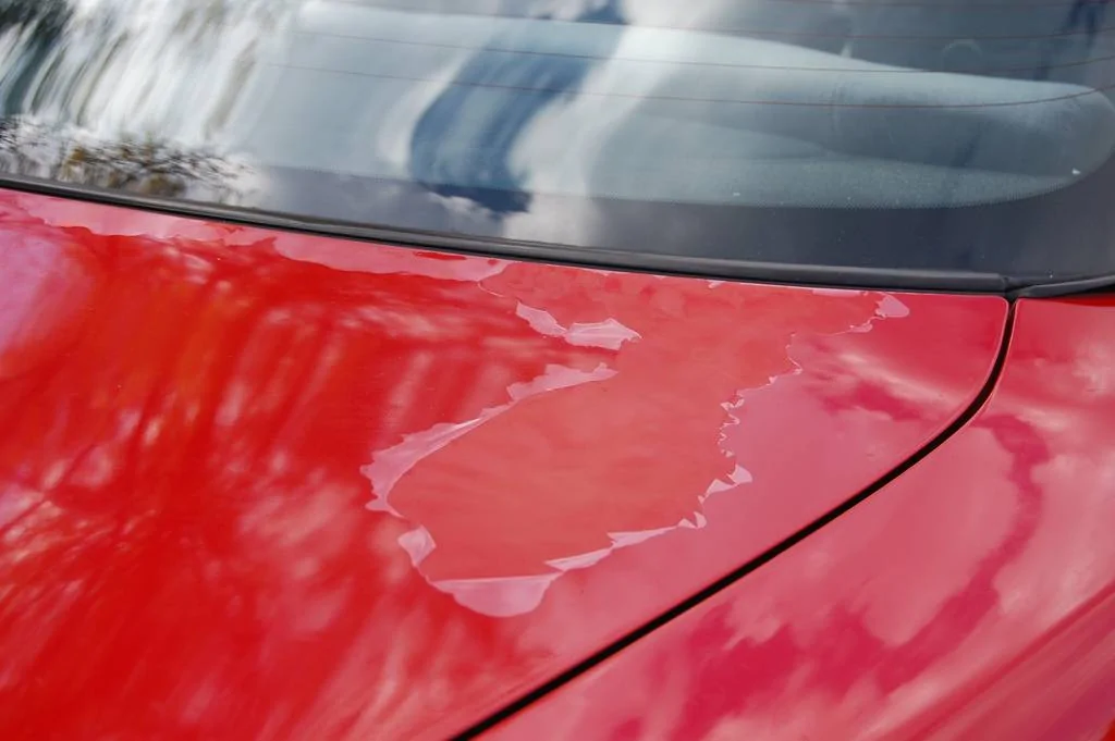

If this is true, I hope that doesn't mean the paint or clear coat will start peeling off on the rest of the car in a year or two. ?
Ford Mustang Mach-E Windshield Glass Recall 21C22 peeling-cc
Note: Stock image
