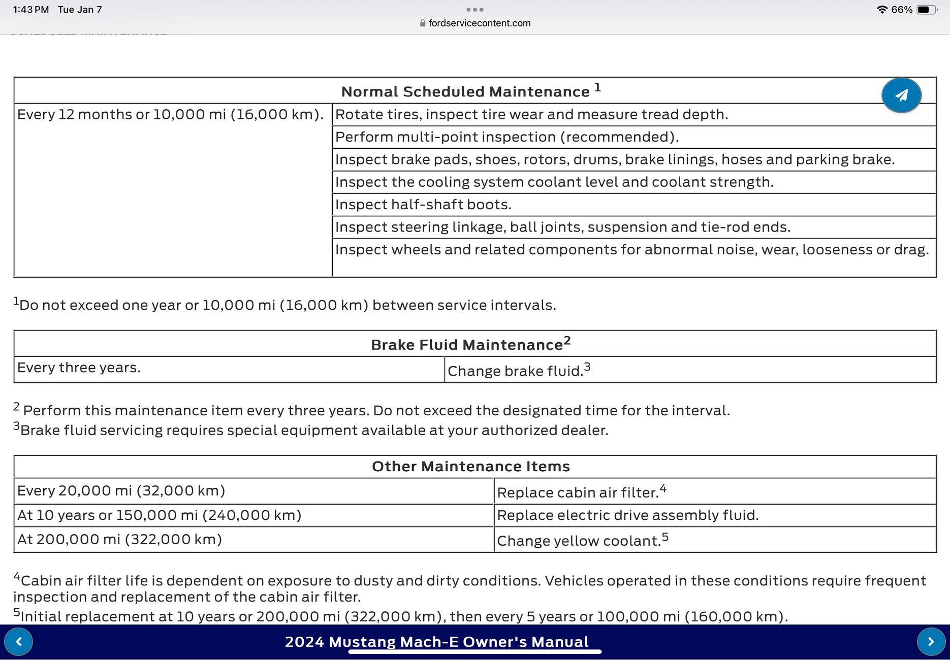

keep in mind, starting with 24 or 25 the manual now doesn't list any replacement intervals for fluids, now it's purely inspect and replace as needed.
erm… The 2024 and 2025 HTML version manual online still lists three fluid intervals. Brake at 3yr, 10yr/150k miles EDA fluid, 200k miles yellow coolant.
Ford Mustang Mach-E 30k service $1000??! IMG_0308
Ford Mustang Mach-E 30k service $1000??! IMG_0309

did they remove brake fluid from 3y at some point?
i saw the screenshots that showed it, so i asked my dealer to do it last month when i went in, but their systems didn't show it as part of maintenance and refused to do it. when i pulled up the maintenance schedule from my fordpass it indeed wasn't on there anymore...
For some reason, I don’t think it ever showed up in FP, but it’s always been in the manual. The FP schedule was (is) strictly showing mileage intervals, no durations, so there was no place to list the brake fluid change.
the 24 pdf manual doesn't list any of that. PLUS if you go to the link posted on ford.com, plug in a 2024 mach e vin you get a run down of what's done at all service intervals. It's all visual inspection and replace as needed. This is essentially the same service listed at 10k mile intervals. It doesn't change until out to around 100k.
here's what happens at your 10,000 miles checkup
  • Inspect the wheels and related components for abnormal noise, wear, looseness or drag.
  • Inspect cooling system level and strength
  • Inspect tires and check tire pressures.
  • Inspect steering linkage, ball joints, suspension, tie-rod ends, drive shaft and U-joints. Lubricate if equipped with grease fittings.
  • Inspect brake pads, shoes, rotors, drums, brake linings, hoses and parking brake.
  • Perform multi-point inspection.
  • Inspect half-shaft boots.
  • Rotate the tires, inspect tire wear and measure tread depth.
Here's the link https://www.ford.com/support/maintenance-schedule/3FMTK1R41RMA53007/
not in the pdf manual starting with 24 model year, as mentioned all the service 10k intervals are essentially the same until you get out to 100k or so.
The revised maint schedule starts at 426 in the pdf manual
it wasn't in the dealer's servicing platform either though. i watched the guy do it: he enters my VIN and mileage, the system spits out the servicing that should get done, and brake fluid wasn't on there. so then as a result he understandably refused to do it [as part of my pre-paid servicing plan].
it's also not here: https://www.ford.com/support/maintenance-schedule/, which is what my online owners manual links to (i don't know where tomato's pictures are from, i don't see that in my manual)...
