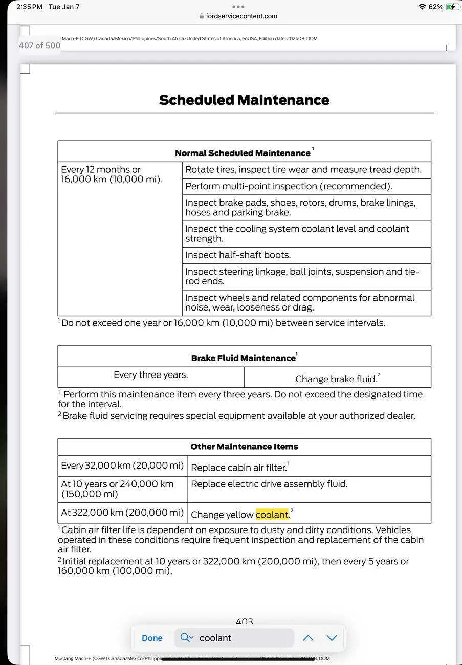

That’s wild, Ford must have a version mismatch somewhere. I got those screenshots from their service website.
https://www.fordservicecontent.com/...e=USA&VIN=&userMarket=USA&div=f&buildtype=web
And the PDF version from that same site shows it too.
https://www.fordservicecontent.com/...tion/2025_CX727_MachE_Owner_Manual_ENG_v1.pdf
I just checked our 2022 vehicle on the service interval page and when i advance the mileage to the point it should show the two mileage based fluid recommendations in our manual it doesn’t show either. It’s only mileage based so I didn’t expect it to show the 3yr brake interval.
They need to fix that inconsistency.
Screenshot of maintenance page from 2025 PDF follows.

yes. it's 3 years old, 22k miles. however like i said i specifically had the service manager type 30k thinking that maybe it was refusing to show the brake fluid change based on mileage and not age, and it still didn't come up (the system doesn't have a field to type in "years", just mileage).

so quite confusing the 24 pdf manual eliminated the fluid replacements and in the 25 manual they appear to have returned.

this is the link for the 2021 manual. strangely under the scheduled maintenance heading there is just 1 sub-section: general maintenance information. in which it doesn't have the table, but only the link that i gave you previously
however in the manual you linked (says 2025 on the top) the header has another subsection. 2024 also has it. 2021, 2022, and 2023 all don't have it.
yeah so clearly there is an issue, but even more broadly you can imagine the servicing platform the dealers are using doesn't have this. the dealer is refusing to perform this action as part of the maintenance and for once i don't blame them.
if you're paying for the service then maybe they'll do it, but i bought the servicing plan and they obviously won't do what isn't required

Hmm…what’s really screwy is when I read the *HTML* version of the 2024 manual it is there, but the PDF version is missing it https://www.fordservicecontent.com/...g_Mach-E_Owners_Manual_version_1_om_EN-US.pdf
Even weirder is that it *references* changing coolant at the specified intervals at one point (page 332) then never specifies them.
yeah i'm noticing it's in the pdf version of the 2021 manual too just not the html one. so i probably got screwed out of it, but again i don't know how i'd ever be able to convince my dealer of it when it's not in their servicing systems
