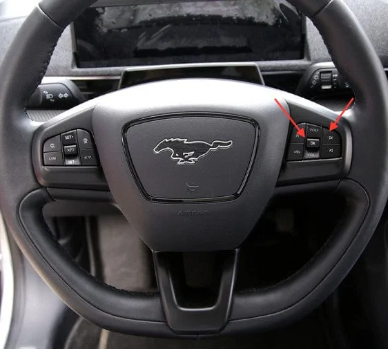

Try doing a soft restart of your software on your Mach-E. Turn your car on, give it time to load and connect to your phone, on the steering wheel hold down the volume button and the next track button at the same time until your screen turns off and restarts again, when you see the ford loading screen again you can release both buttons. Should help with software issues/glitches.
Has worked for me, hope it helps.

You do realize that's just a reboot of the Sync system right? It has nothing to do with anything else and will not affect any updates or downloads.
