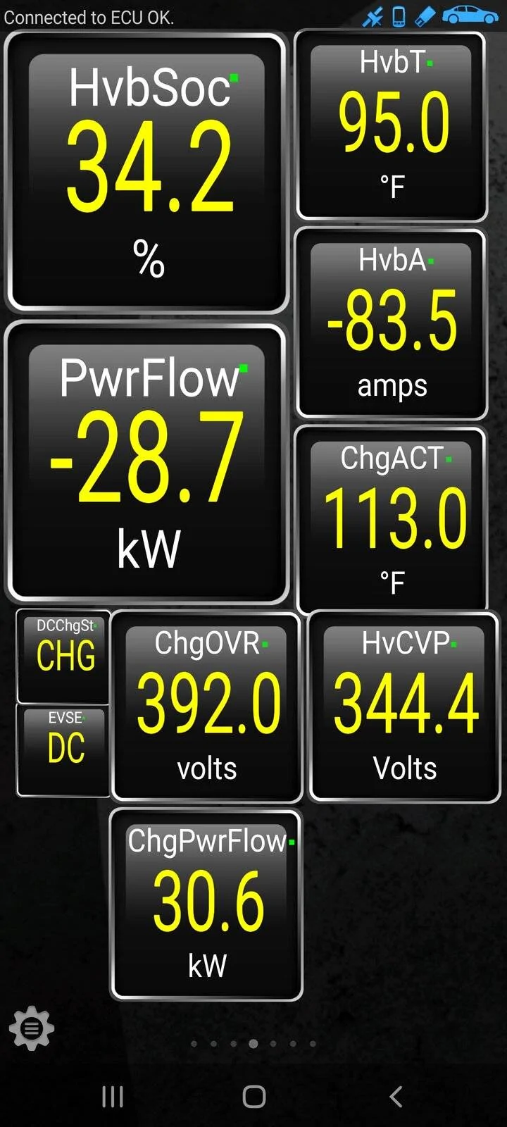

Plugged into an ABB 350kw charging station, using plug and charge. I plugged in and ran into Walmart to get a drink and use the restroom. Got back out, and the car hadn't charged much. Was stuck at 31kw. Checked temp's and such with Torque, and everything looked normal that I could See.
Ford Mustang Mach-E 900 Mile Road Trip Report Screenshot_20210721-111557_Torque
I Then moved to another 350kw station, and the same result. Finally moved to a 150kw station, and charging went to normal. Spent 20 more minutes charging and then moved on to the next stop.

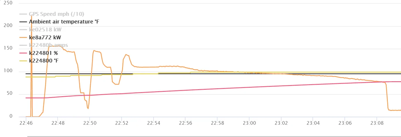

This was on Friday after I had been in Memphis. There is only one DC charging station in all of memphis, and was 30 minutes from downtown where I was staying. This was an interesting stop. I plugged into a 350kw Signet unit, and again had great charging right from the start. However, this time the charging curve did something I haven't seen before.
Torque reported an initial spike of 223kw for just a second, then dropped back to 0kw. It then started normally charging at 156kw for a few minutes, then tapered down to 142kw like usual after 2 minutes. However, it then tapered down to 18kw. and then back up to 146kw. Then started tapering down again, and then dropped to 70kw, then back up to 136kw. Before finally settling down at 110kw through the rest of the charge.

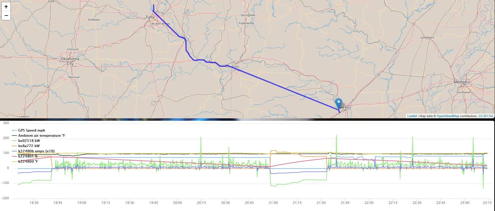

I tried to log the entire return trip with Torque, but I apparently didn't set something up right and it only got the last bit of the trip home. It looks like it only tracked GPS when the app was open. But other stats keeps recording.

Thank you for this informative write up. I am a novice with EVs but the spikes seem unusual even though it is great to see the peek at 223kw. Hopefully, our Ford Co. friends here would look into this to see if there are any lessons learned and opportunity for future improvement.
