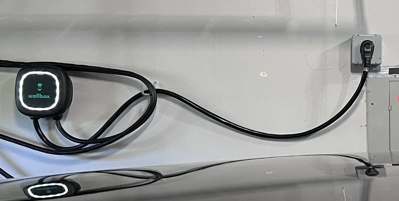

I'm curious though - why not hardwire the ChargePoint? Seems like it would be much easier. That's what I did, though I'll admit my situation is rather unique (my EVSE is installed near the ceiling of my garage since it's the only place it will fit).
Years ago when my house was built, I installed a 14-50 outlet knowing that I would probably have an EV at some point in the future. So I just wanted to use that instead of having to redo it. I also have a garage heater that I plug in sometimes.
I mounted the EVSE so it’s directly in front of the charging port on the front wall of the garage. I recall the outlet had to be off to side a little because of sink pipes in the ideal location. Didn’t think it would be a big issue back then but unfortunately NEC has since limited EVSE cords from 6’ to 1’ or less, which necessitates the use of a range cord in more install situations. I wish they would amend that to 2’ so you can mount on the next stud down if needed. It would also reduce the extreme plug strain I see in some installs.
