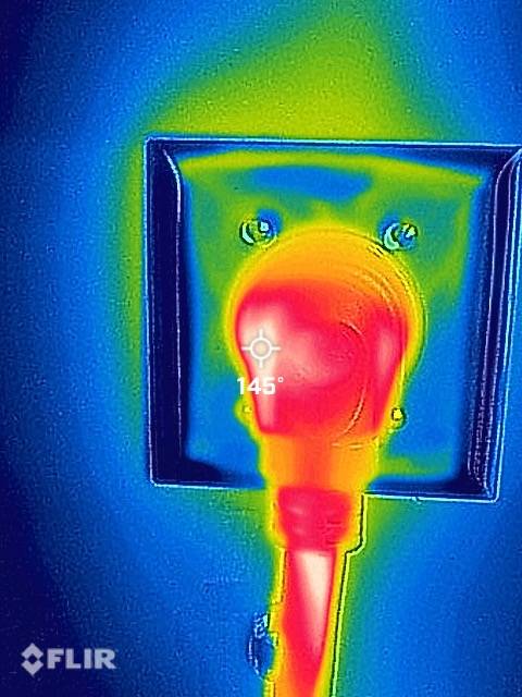

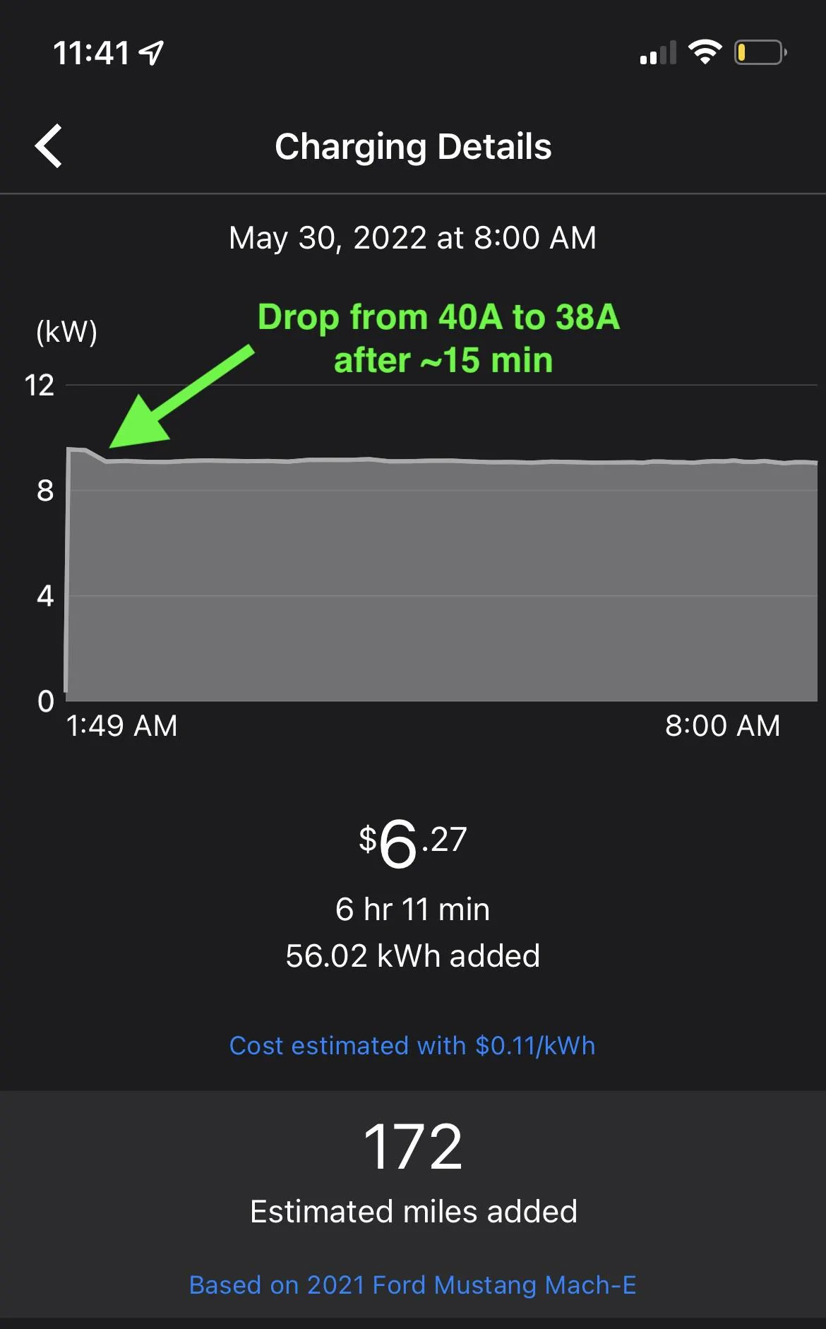

I wanted to share my experience with a range cord that ended up being faulty. I had to mount my ChargePoint in a location where the included cord didn't quite reach the 14-50 outlet, so I bought a 50A range cord to use instead like others have done. I chose a GE (well-respected brand) model WX09X10037 cord, which is rated for 50A and is UL listed (again thinking that means it should be good quality). This cord has good reviews on Amazon, 4.7/5.0 with 329 ratings, and other reviewers have said they've used it successfully as an EVSE cord.
However after installation I noticed it would get quite warm while charging, up to 152ºF when my garage was only 70ºF! You can see the left side got quite a bit warmer than the right side, which indicates a bad connection:
I also noticed my charging speed would drop from 40A to 38A after about 15 minutes of charging:

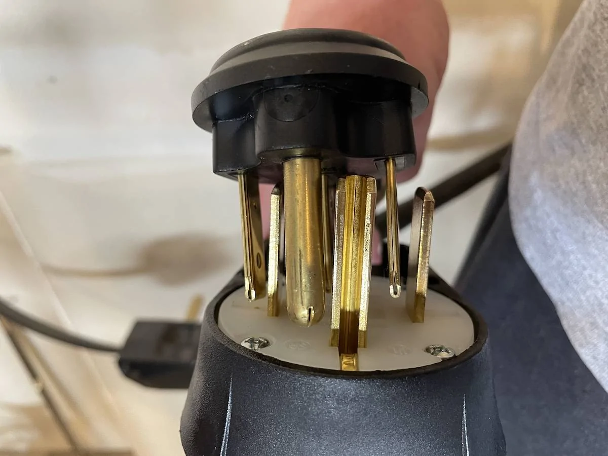

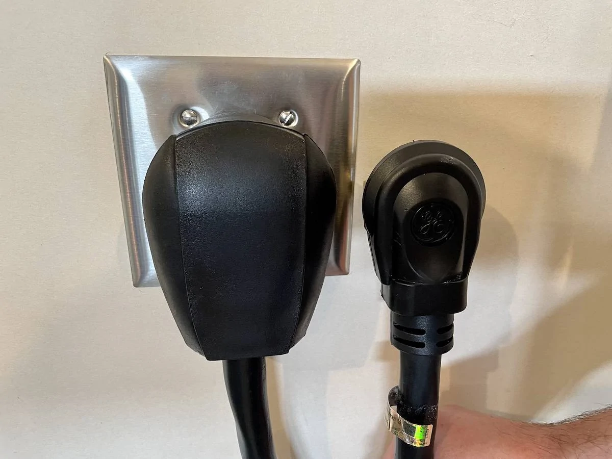

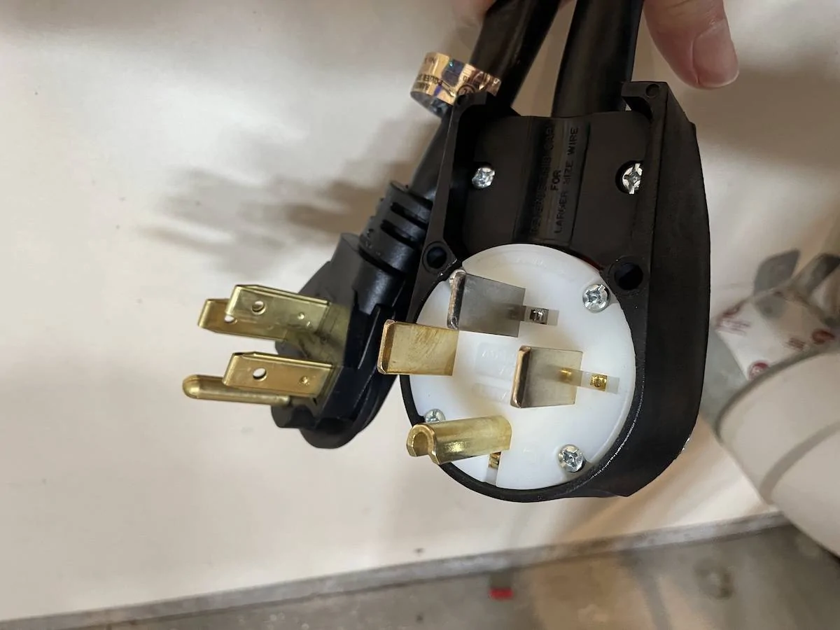

At first I thought my receptacle could have a loose connection, so I took it out and loosened/torqued everything to specs again. Still got hot, so then I replaced the receptacle with a Bryant (clone of Hubbell) 9450FR industrial-grade receptacle, torqued to specs. Alas, it still got hot, so it had to be the plug not the receptacle. So I ordered a Bryant 9452ANPB industrial-grade plug to try instead.
There is a huge difference in construction of the Bryant plug vs. the GE. The blades are much thicker and solid brass, compared to the thin, folded over blades of the GE. The attachment lugs inside are also very robust, thick metal everywhere. The plug is expensive, but you are getting what you pay for.
After cutting the molded plug off the range cord and replacing with the Bryant plug, I can say there was a huge improvement in the plug heating! Testing the prong temperature, it barely gets warm now (100ºF) vs. the burning hot (152ºF) of the GE plug. Check your prong temps!
I did some additional testing on the GE plug, and found the internal resistance of the left and right prongs to be 8 and 4 mΩ, respectively. This is far above the 1.5 mΩ threshold for a safe connection at this current level. In contrast, the internal resistance of the Bryant prongs was less than 1 mΩ, excellent.
In conclusion, there is a poor internal connection between the prongs and the wires inside the molded range cord plug head. This creates an unsafe level of heating which may have caused the connection to weaken and eventually fail. Even though this product is UL listed, it is of inferior quality and would fail the UL 817 temperature test with greater than a 54ºF rise. Reading through reviews, others have reported the same hot plug issue with this cord after finding the same internal defects, so there seems to be a lot of variation in the quality of the internal connections, not good. Therefore, I do not recommend you buy this style of range cord! This 50A cord is also sold under other brands including GE, Southwire, HDX (Home Depot), Electrolux, and Smart Choice. The plug is marked E72389-F PHILIPPINES between the prongs for reference.
In addition, after replacing the plug I no longer notice the 2A drop in charging current, and I'm getting a solid 9.5 kW now. I did some investigating and it appears that the Mach-E (not the ChargePoint) dropped the charging amperage after noticing the increased voltage drop from the poor connection heating up. Yes the internal charger (SOBDM) monitors voltage drop and responds appropriately. If you see a drop in charging amps/power a few minutes after charging starts, it's probably a clue you have a bad connection heating up somewhere and you should investigate. Thermography is a great tool for finding hot connections, but feeling with your hands (safely) also works well. Anything with more than a 45ºF temp rise above ambient should be suspect.
No more problems, I strongly recommend going with the Bryant 9450FR NEMA 14-50 receptacle and the 9452ANPB plug if you want the most robust 14-50 connection possible.

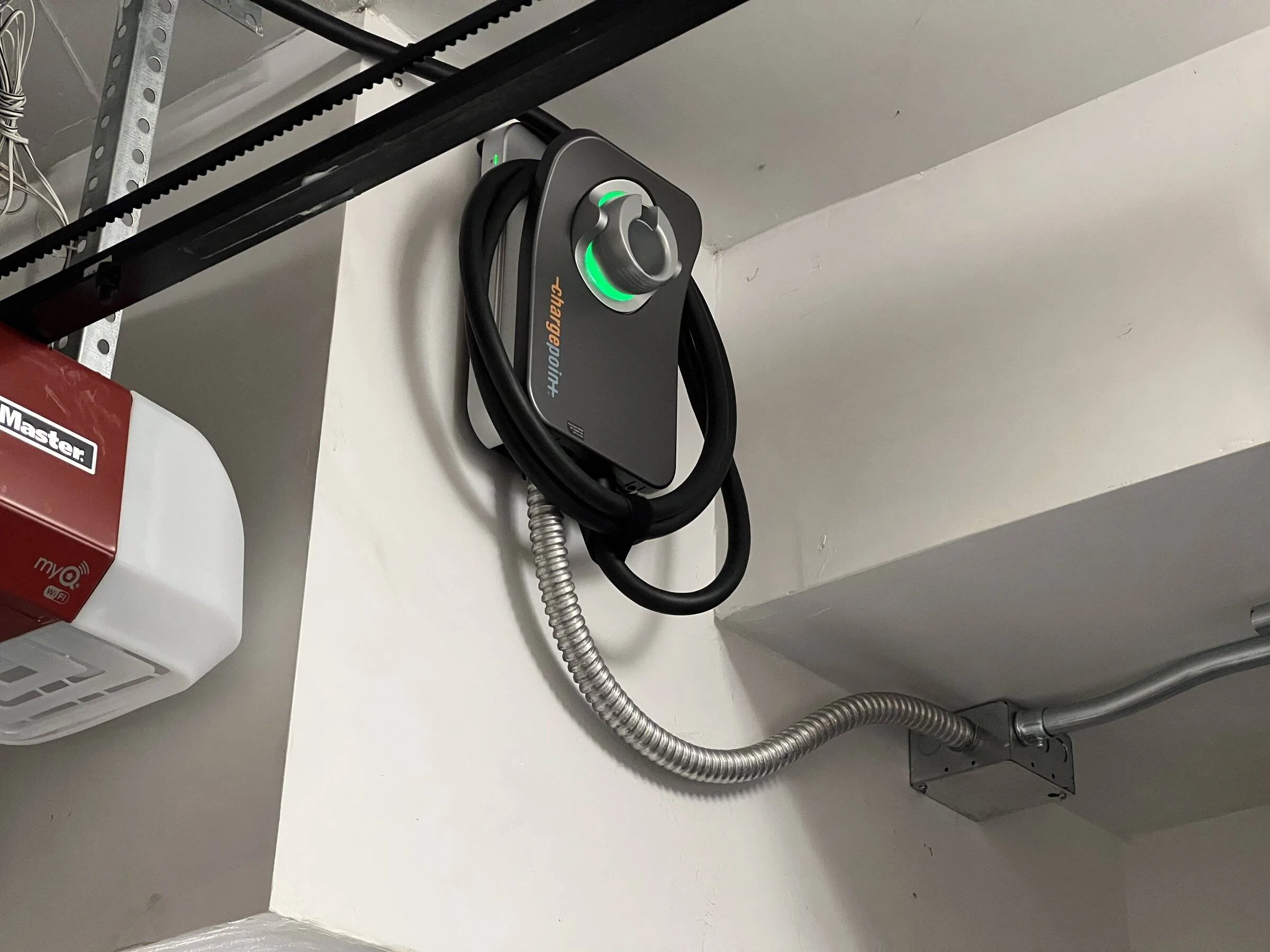

As others have said, thank you for your post and deep examination of this topic. It's very important stuff since it can literally mean the difference between a house burning down or not. It's also good to know the Mach E is engineered to properly detect voltage drop and reduce current draw accordingly. While that would hopefully prevent catastrophic failure, it much better to get a high quality plug!

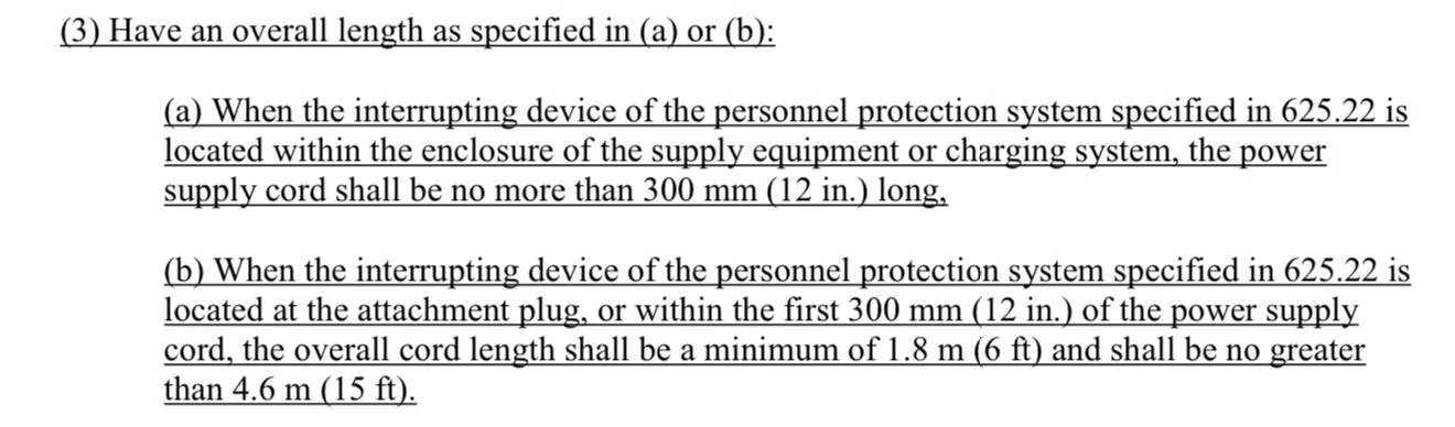

I'm curious though - why not hardwire the ChargePoint? Seems like it would be much easier. That's what I did, though I'll admit my situation is rather unique (my EVSE is installed near the ceiling of my garage since it's the only place it will fit).
Years ago when my house was built, I installed a 14-50 outlet knowing that I would probably have an EV at some point in the future. So I just wanted to use that instead of having to redo it. I also have a garage heater that I plug in sometimes.
I mounted the EVSE so it’s directly in front of the charging port on the front wall of the garage. I recall the outlet had to be off to side a little because of sink pipes in the ideal location. Didn’t think it would be a big issue back then but unfortunately NEC has since limited EVSE cords from 6’ to 1’ or less, which necessitates the use of a range cord in more install situations. I wish they would amend that to 2’ so you can mount on the next stud down if needed. It would also reduce the extreme plug strain I see in some installs.

The cords can be over 1ft per code, but the GFCI circuit must be within a foot. Seems silly, but hey…
very interesting.... especially that you measured different (higher) resistance in L1/L2
I've had problems with other cords that came with molded on plugs too.... I would not recommend pulling more than 32amps thru any of them.
