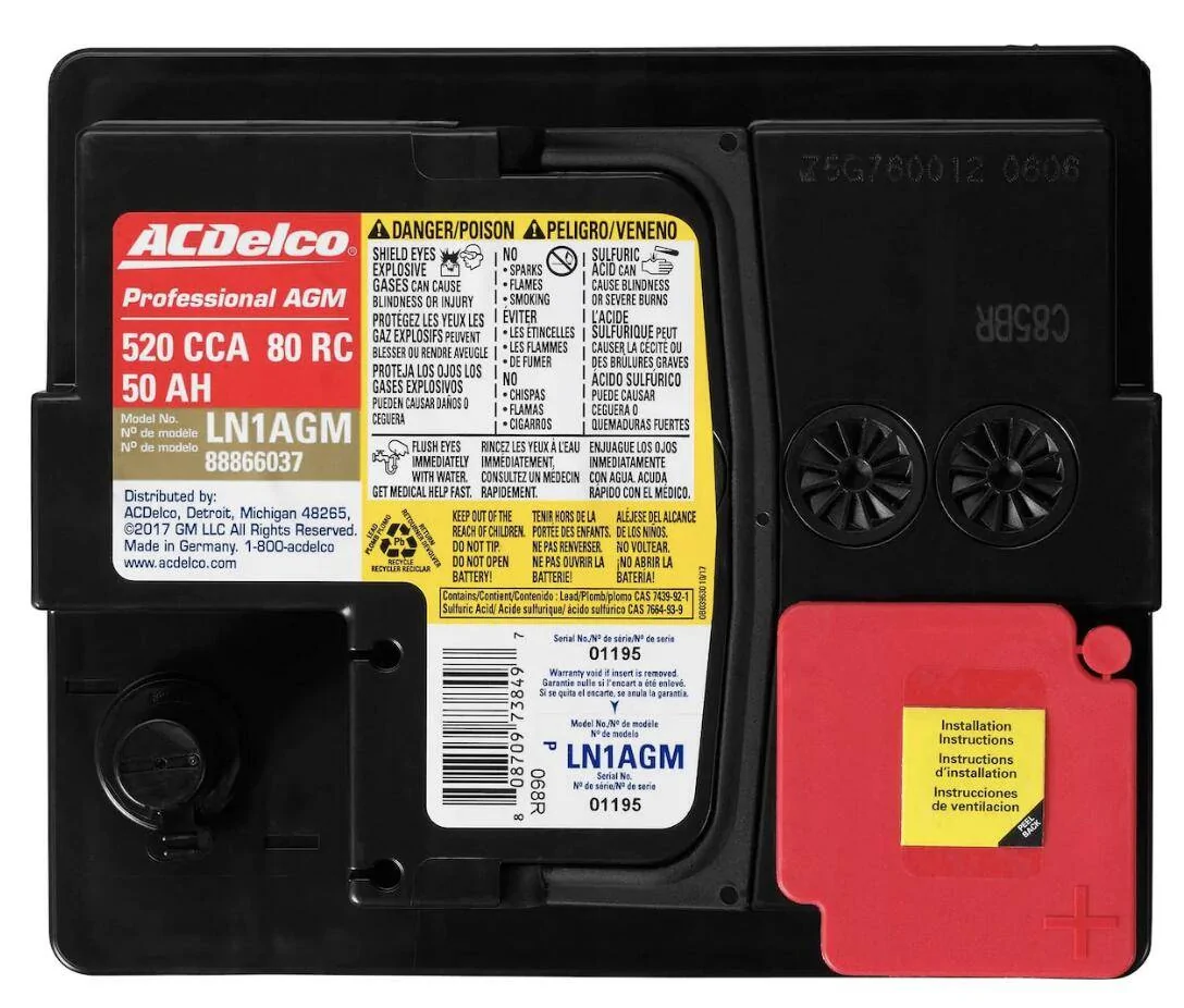

@kram recently reported that he found that a Chevy Spark AGM battery works in MME. I did some googling, this AC Delco part LN1PS is quite interesting indeed, 50 Ah (compared to our 35 Ah). It looks like it would take advantage of the second battery length position (see numbers by @OWG) that I have been wondering about: Summit Racing, $155, free shipping; Rock Auto $136 + $16 shipping + state tax. I ordered one to add to my 12V LVB study. Note that a different battery size might add complications with our BMS system which expects a 35 Ah battery, not sure, definitely curious to explore.
