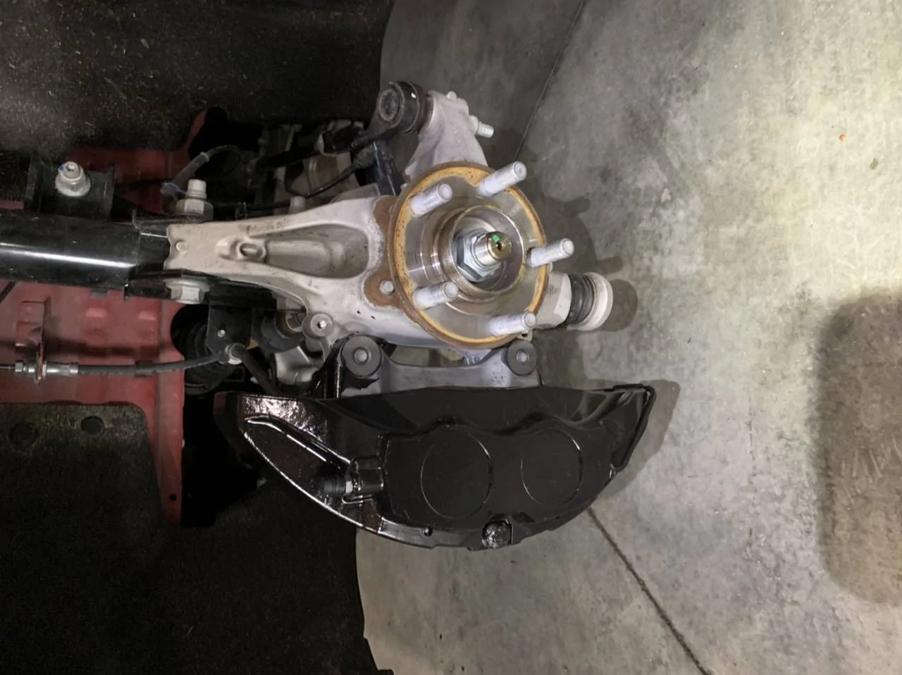

I ended up doing a brush on kit on my car a few weeks ago. I still moved the calipers, got the rotors and backing plates out of the way, and then put the calipers back on the brackets. I used Duplicolor on my car. Just today I did the wife’s car with a brush on Por15 paint. It was much better quality but has a 24 hour dry time. So her car remains on stands to be reassembled tomorrow.
Ford Mustang Mach-E Any challenges to removing calipers 92711D9B-14B4-43C5-8F03-E47EEC6404D6

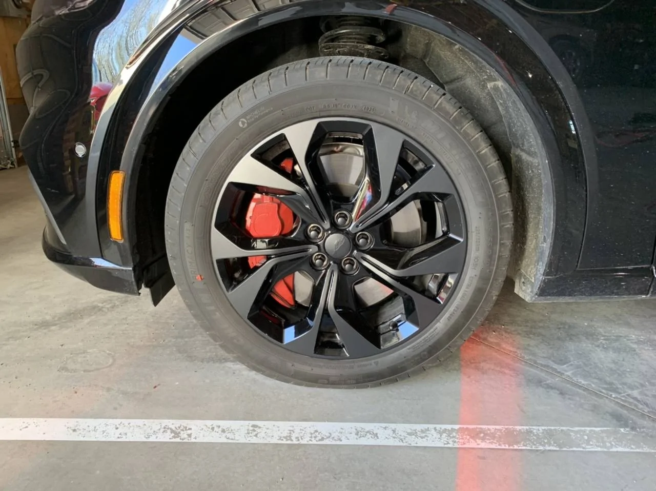

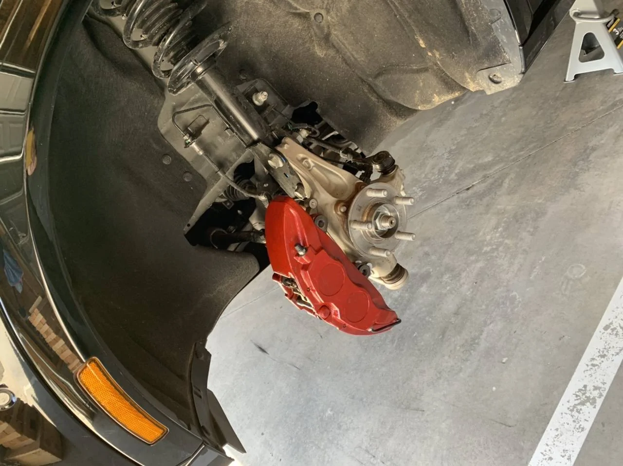

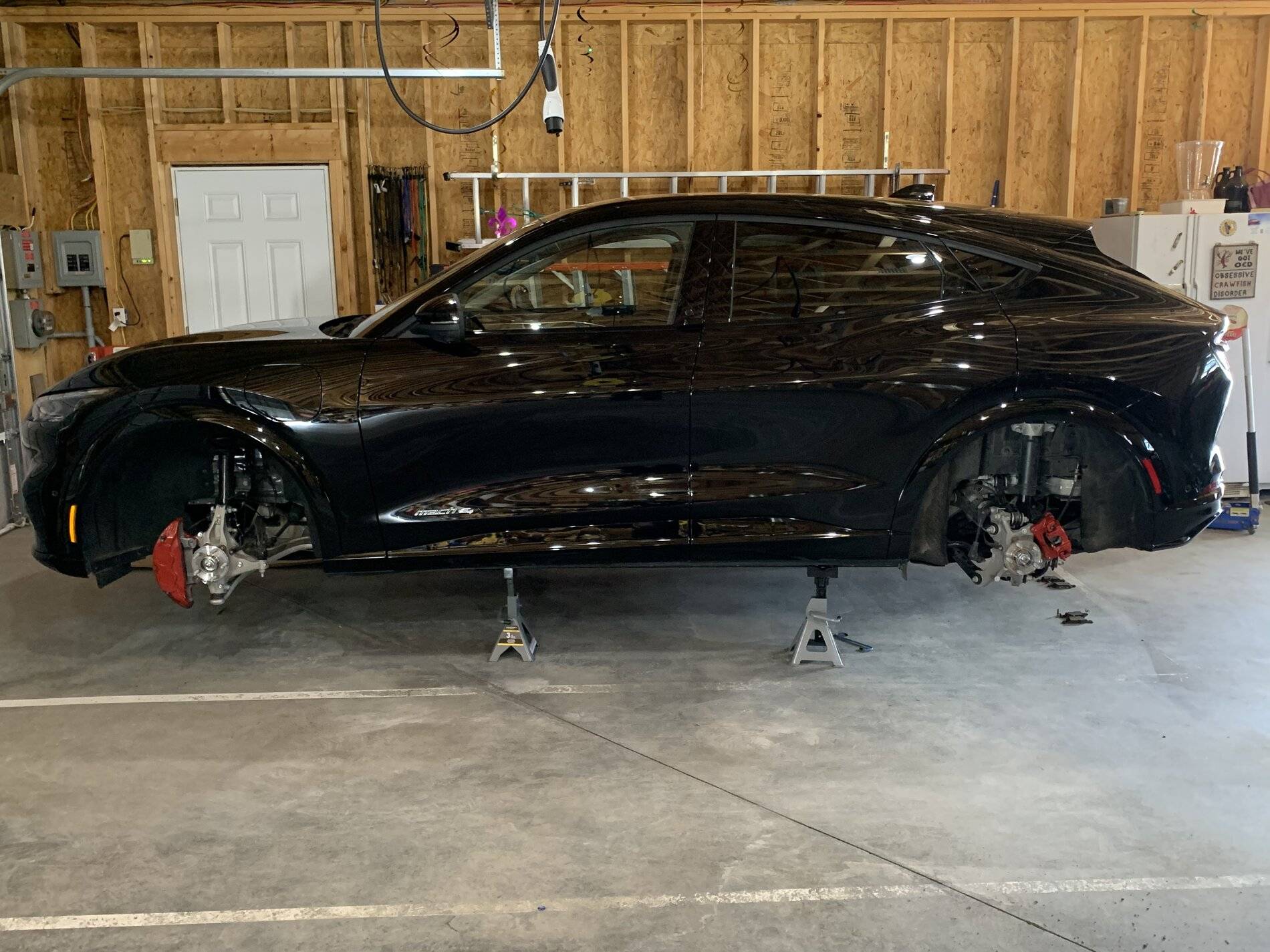

I guess the other car you used red. Can you post some pictures? I was thinking in doing mine red as well. Thanks.
Ford Mustang Mach-E Any challenges to removing calipers 7A69A736-0A50-401B-809F-DA1FD3D5F181
Ford Mustang Mach-E Any challenges to removing calipers CD8697AE-6E2C-446F-9262-99389CAE25BC

Ford Mustang Mach-E Any challenges to removing calipers 4A8D7C3C-A0BD-4CED-9288-DB8656859847
The calipers were my first mod. I don’t even recognize that as my car now. ?
