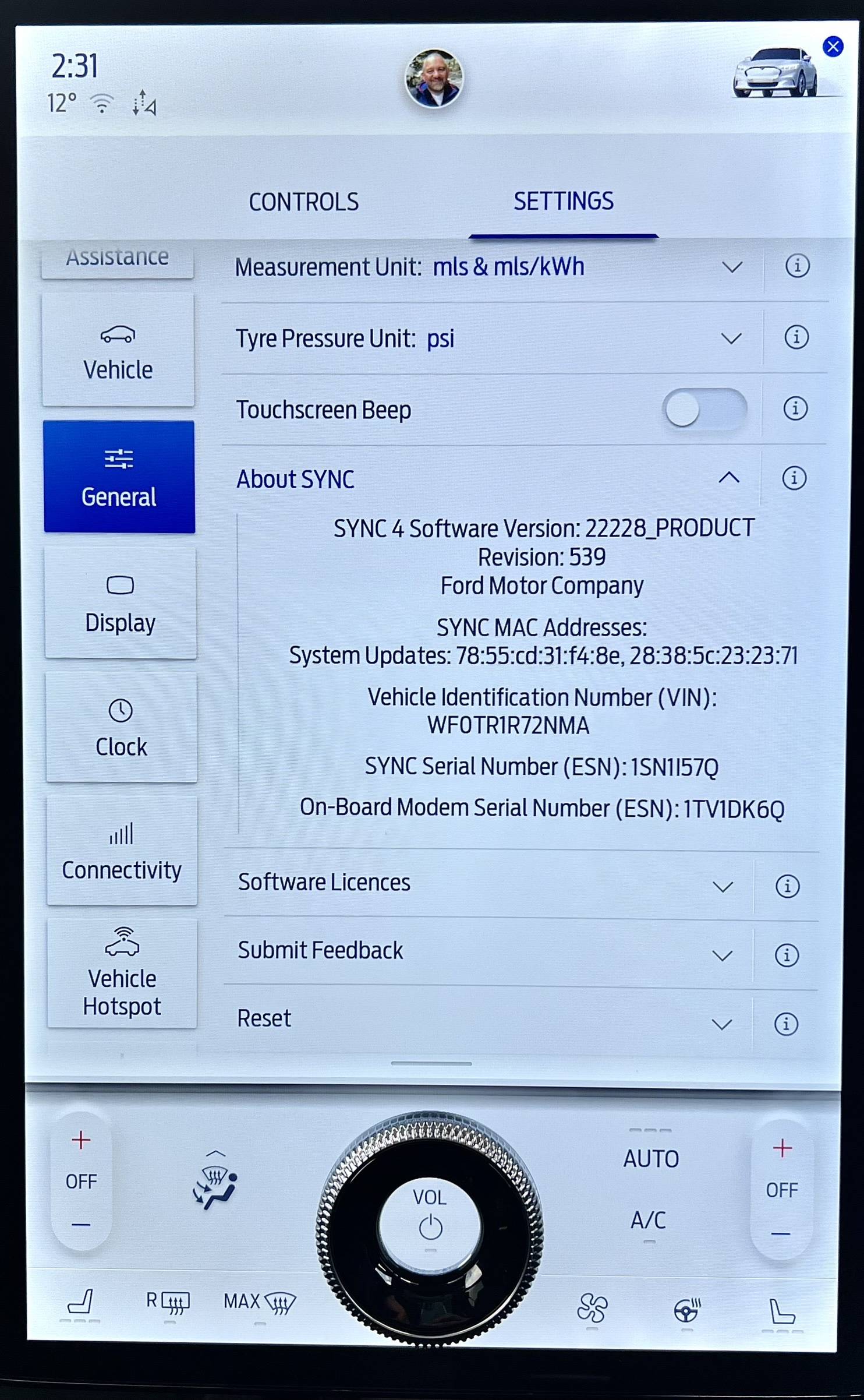

This is the one where if you did the update to the BCM before the GFM update was available you'd end up with a "Frunk System Maintenance Required" error until the GFM got updated to bring everything back into sync. Once you do the GFM update on a J1 car it also give you the ability to open the frunk with the door keypad. And as of this morning with Sync 539 installed there is now a working frunk button in the Access menu for '21 J1 cars as well.
Probably going to be a while before we get Sync 539 pushed to us though.

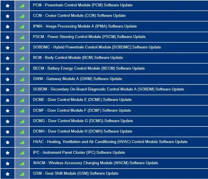

I can almost guarantee it won't show up until this gateway module is updated first:
Ford Mustang Mach-E Anyone know what 22P25 is? WF0TR1RM4MMA30003-27-Sep-22
Are those the module updates on my VIN Mike? I’d have thought the list should be getting shorter by now, not longer! Hopefully some might get pushed OTA but I doubt it, shame I don’t have a need to visit my dealer at the moment.
Those are yours, yup.
