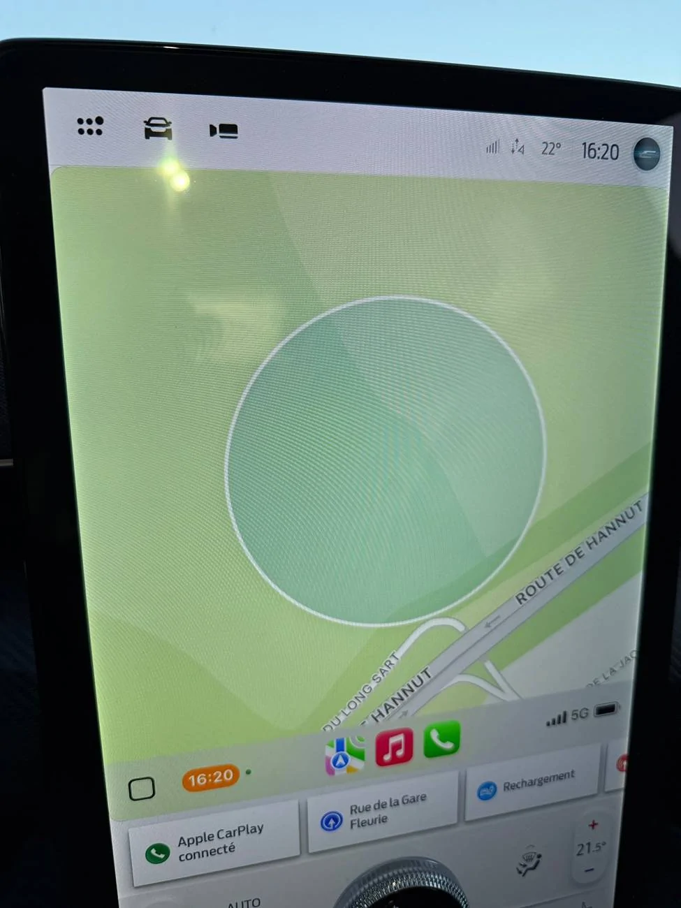

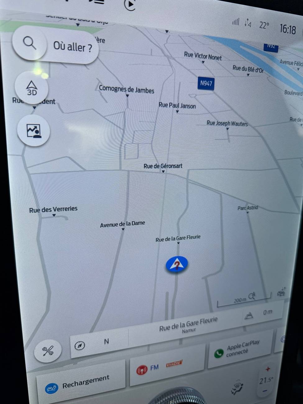

Have same issue, I was using the 15 pro max then 16 pro max so it’s definitely not the phone. Had a full car reset in a try to solve this. But not only I have the same thing on Apple Maps/carplay but also with the integrated one.
Ford Mustang Mach-E Apple Maps Navigation is unusable IMG_0180
what I had was a blinking interrogation mark where the car was last power on. System wasn’t able to put it back on current location.
CarPlay was showing me somewhere in that bubble without being able to fix the localisation.
Ford Mustang Mach-E Apple Maps Navigation is unusable IMG_0181
have the car since two months now and already feeling that was the worst choice I could have made. It’s bug on bug and the pitty choice of not updating / fixing bug by software update drive me totally crazy

When this happens, where is the phone? In your pocket? In the center console? In a backpack or purse?

In the console slot where the charger is.

Nb : I no longer use neither that shitty qi system as both my two phones when they were there goes extremely hot and the CarPlay cordless was draining out my battery. So I put a MagSafe directly connected on the usb c port.

What console slot? Do you mean the center console with the sliding cover behind the cupholders? Is the cover closed or open? Or do you mean the wireless charging tray that is under the center screen? And is the phone face up or face down?

Face up and in the wireless area

It's the phone. It's been an issue with the 14 pro+ When they switched to the 'super accurate gps chip' It turned to accurate as long as you're not using it. I randomly get the issue with my second pro15 max. This one is slightly better but when the apple maps go walkabout I toss it on the dash infront of the big screen and it goes back to working and accurate within seconds. I can then put it back on the charger in the console. I've even had it go crazy in different rental cars, but always when wireless car play. Corded seems to be fine.

What happens if you move the phone to the cupholder area?
I see this same problem when I have the phone in my right rear pants pocket, with the phone upside down in my pocket. That is, to say, with the camera side pointing downwards and the charge port of the phone sticking out of my pocket.
If I move the phone to
a) the center console under the screen (wireless charging area, but not being wireless charged),
b) the cupholders
c) passenger seat
d) re-orient it so that the top of the phone sticks out of my right rear pants pocket
then the problem disappears and I get a good GPS lock. This is on an iPhone 13.
