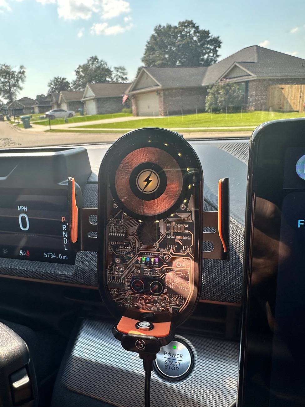

Is that a flux capacitor ? Are you from the future where all CarPlay problems are solved ?
