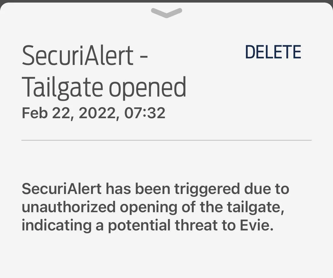

Ok, last comment, then I'll let this go. I just noticed that SecuriAlert sent the message below (I get such messages well after the fact). I was able to unlock the doors, start the car, back it out of the garage and then use the kick to open to open the liftgate (to inspect for damage). All of these events triggered similar messages about 'unauthorized' access. How is it possible that any of these operations are 'unauthorized', yet allowed? I mean if I stick my foot out, shouldn't the liftgate just stay closed if I am not authorized? Just weird. :rolleyes:
