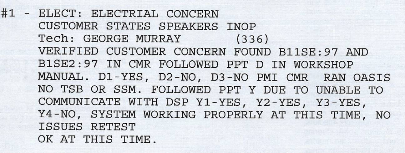

What do these codes mean?
No idea, it’s what was printed in the repair sheet.
Since my problems were the speakers and driver facing camera I assume they relate to those issues.
I posted them in case someone else has the same issues to give them a starting point with the dealer.

Here’s the work order.

Two Ford engineers were at the dealership to try to find the problem. No success. They are going to have a call with the system architect tomorrow.
It doesn’t look good. Unfortunately! :-(
it may be more complicated than just bad speakers replace type stuff -hang in there - too bad its happening

Youd think that its a connection issue or a bad amp.
I went to pick up my Premium RWD yesterday. Last item on my checklist was audio and same symptoms - No audio, no volume indicators, but Sound settings (balance/EQ) were still there(?) My saleswomen swore she had tuned in satellite the previous day.
So we rolled it over to the Service bay and a tech comes out with his laptop. The diag showed the DSP (amp) module was unresponsive and a soft SYNC4 reboot was not brining it back. They kept it last night and told me at pick up today it required a full power cycle and dodged telling me any more other than "Ford is having some OEM vendor chipset problems" similar and vague to what I've read here in forums.
Guess we'll see how many days mine stays working ... #EarlyAdopter

If there's no sound its literally the only 2 issues it can be. If we see a trend i.e. more than 3 ppl with the same issue, there might be a bad batch of amps if your issue comes back
