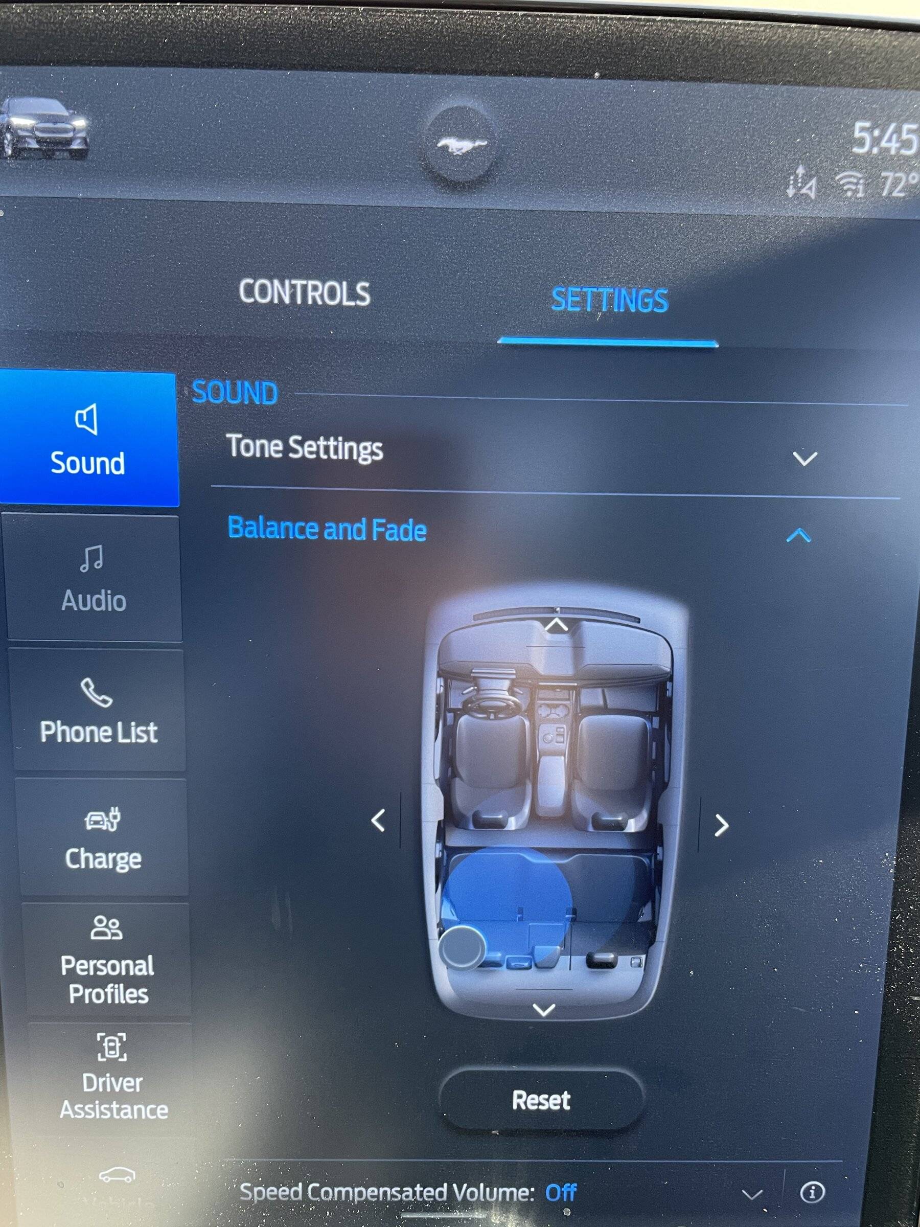

I’ve had no issues for the 13 months since delivery of my car (knock on wood). Then suddenly, the audio stopped working in my First Edition yesterday. I’ve attempted to fix by resetting/restarting Sync system, but still volume controls no longer reveal volume indicator in display. CarPlay connects, FM radio displays, etc. just no sound. In the settings, Audio is not able to be accessed.
I’ve tried resetting system, changing profiles, etc. Any other suggestions or ideas what could have caused this? and how to fix?

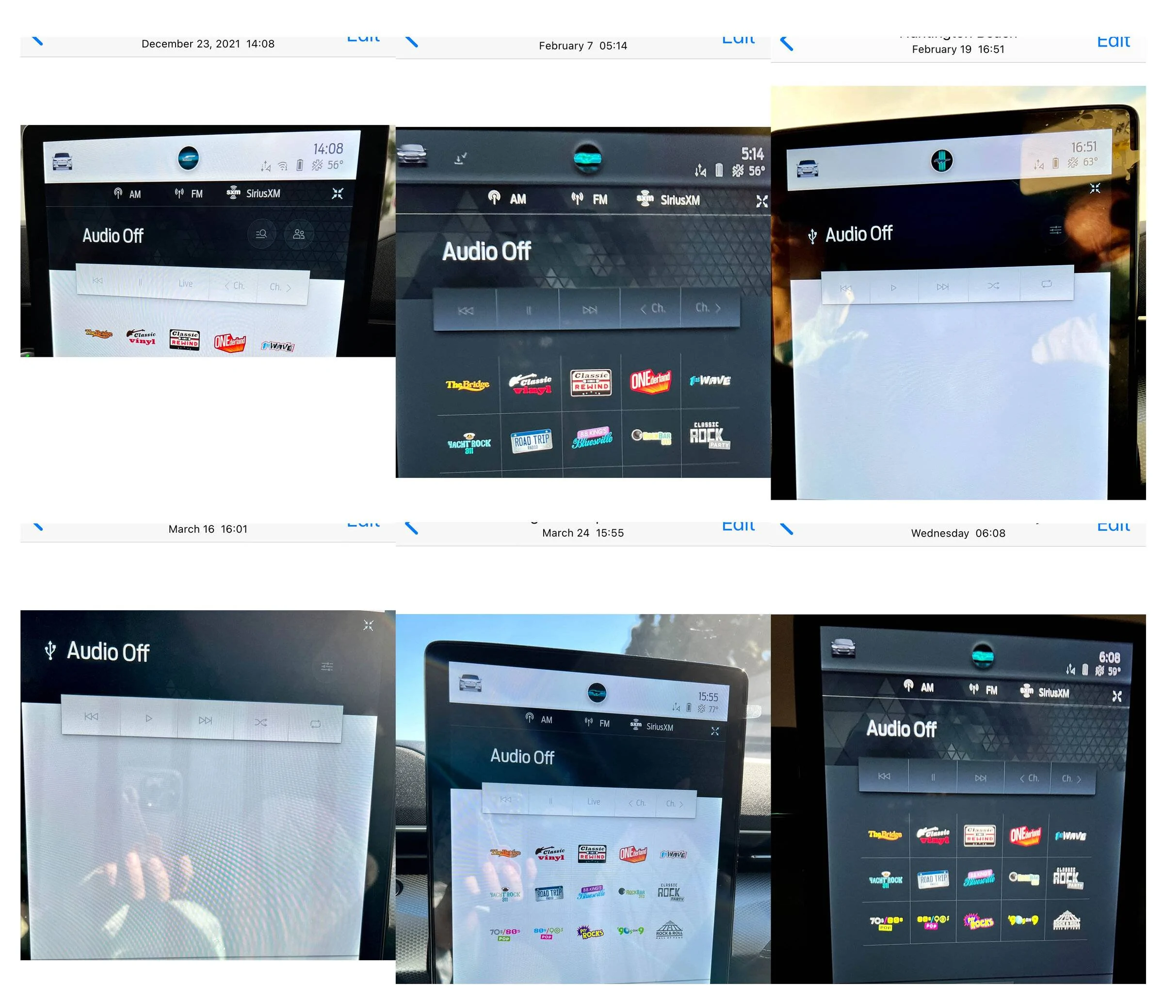

I often lose audio (Audio Off) it just pops up randomly. Not pressing buttons, steering wheel controls, talking/singing etc. It'll just stop and flash up Audio Off 'error'. Other times it will just go silent without the Audio Off message. I'll hit the volume up and the bar will increase but no sound comes out. Usually I can just hit the center of the SYNC dial to turn it back on. When the volume just shuts off, I need to reset the SYNC screen.
I capture them when I can, it's been pretty much since I got it, July 31, 2021
Ford Mustang Mach-E Audio Not Working AudioOff
And this isn't even the constant SYNC garbled screen errors I still get.
