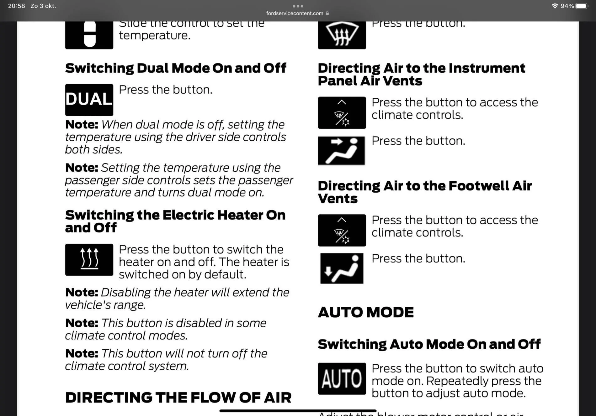

Yes, A/C is often used to remove humidity.Now my question is, does AC do anything when e-heat is on? Question of limiting unnecessary current draw. I mean just like a home AC unit when it gets too cold outside and since there is no heat generated by any engine what does AC do at this point if E-heat is on?

Understood but since we are using an electrical heater rather than scavenging air from the engine bay, doesn't this dry up the air already? Like using forced air heating rather than radiant.Yes, A/C is often used to remove humidity.
Maybe, but I’m sure it could use some help. Cars never directly blow air in from the engine bay. They use hot coolant and transfer that heat to a heater core that air blows through. The source air either comes from outside or is recirculated from within the cabin.Understood but since we are using an electrical heater rather than scavenging air from the engine bay, doesn't this dry up the air already? Like using forced air heating rather than radiant.
