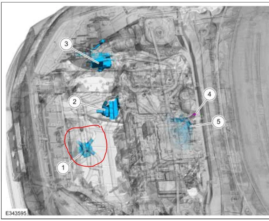

The battery and TFE heater are on separate cooling loops that can be connected or shared. They are isolated loops that can be combined if the car chooses. It does that via a diverter valve shown here:
The Munro boys keep calling it a PTC heater......heck, I did too. But now that I see it in that video, it doesn't look like PTC at all to me. The PTC heater in my Focus was about the size of a shoebox. MUCH larger than that what the Mach-E has. Judging by the size of that thing....it has to be a Thick Film Element type. There is no way a PTC of that size would come close to warming the battery and cabin. At least, not any PTC that I've seen anyway.... ?

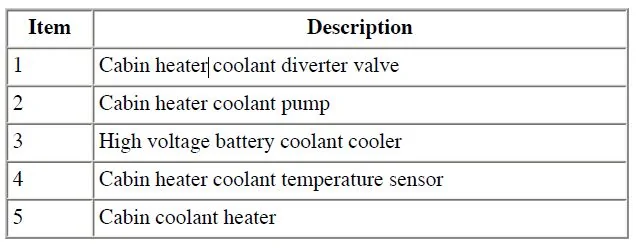

I've been searching the forums (probably poorly) looking for more info on this system. Any way to get a legend to this image? Which item is the TFE heater? Thanks!
