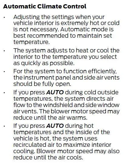

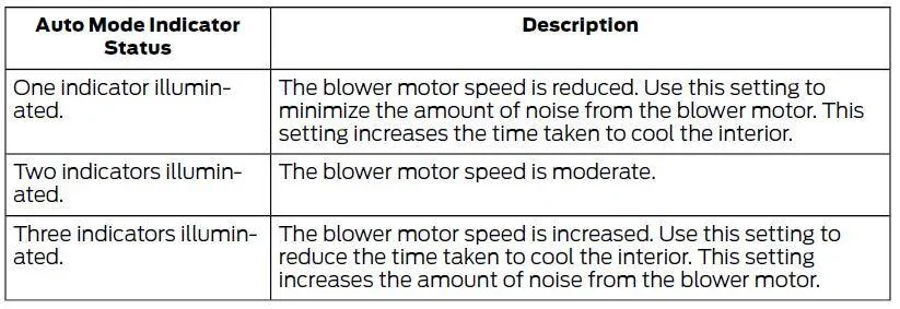

i've always stuck to 1 for the same reason but based on the manual's explanation, it sounds like it's just changing the fan speed and not the amount of energy spent running the cooling/heating elements?
if that's true, it is potentially possible for auto3 to be more power efficient than auto1. yes you use more power for the fan, but you cool/heat the cabin faster meaning the cooling/heating element can switch off, no?
Higher fan speed will use more energy for the blower motor, and more heat because of greater exhaust rate. I use higher settings if I want more air mixing, or if I have rear seat passengers and need to get heat blown back to them.
The most efficient setting is AUTO 1, with the temperature set as low as you can tolerate.

The auto number doesn't have any direct correlation to a fan speed number, at least not according to the manual. It's just about how noisy you want it to be (or don't want it to be).
Honestly though, the Mach-E HVAC system is one of the worst I've had. Its auto mode is complete garbage and I constantly have to redirect air to defrost or make adjustments - despite it saying it blows on the windshield in cold temps. My 4Runner from almost 10 years ago had a WAY better auto climate control. I only ever touched that if I wanted to go up or down 1 or 2 degrees. I NEVER had to worry about where the air was or wasn't blowing.

It controls the max fan speed of climate control. For people like my mother who hate car fans at full power it is great as she would limit it to the lowest settings.
Do note if all it needs is lowest fan speed to keep your car at a given temp that is what it will use in Auto no matter what you have the max set to. I personally leave mine at Auto 3 so it gets the car quickly to the temp I want then I like go down the the slower speed.
