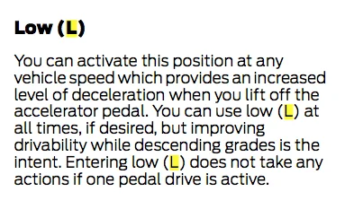

If I’m in whisper, would 1PD with L make braking similar to unbridled but allow me to keep acceleration the same as whisper? I like unbridled for the 1PD slowing force, but prefer Whisper.
I haven’t tried that, but I think yes. Others may have better info.
As quoted in the 2021 manual it doesn't sound like it, but the author of the manual may not actually have known for sure:
Ford Mustang Mach-E Bake regen questions. Screen Shot 2022-01-09 at 3.13.14 PM

It sounds like (and I think it’s been mentioned by others) that L is pretty much a quick way to switch 1PD off and on.
The amount of regen braking from L will not exceed what you would get with 1PD in the mode you’re in.

That's what I was thinking, too.
