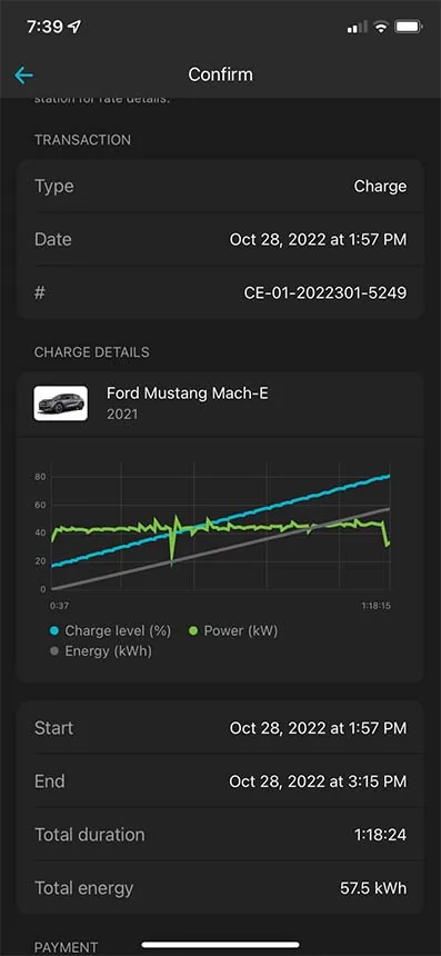

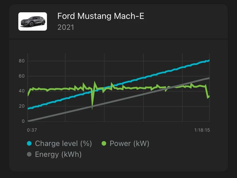

@devmach-e thank you I understand 44 KW max it is. About it dropping to 33 KW as soon as it hits 80%. This is at the cars request?
My guess is a recent update to my car has caused my 80 to 90% charging rate to drop to 33 KW at 80% soc. It appears to be hard coded and not based too much on physics or current condition. I'm assuming that 44 KW charging on a 50 KW charger before it hits 80% has an adverse effect on some part of the system therefore a max limit has now been put in place?
Confirmations from others would help. I am getting a drop to 33 KW since this car was updated early October. Having 43 KW 80 to 90 for the summer did no good. If it is a seasonal thing I pick the winter.
I will sit there if needed but the DCFC capabilities of this car have to be better than that? 44 KW 15 to 80 and then 33 KW at 80% is what I currently have. I have seen a steady 43 to 90% with no adverse conditions noted. My November tripping is going to be interesting if that critical station is still down. I will run in on the way down when not needed on the first leg from home just to see if I can count on it on the way back but apps are saying maybe not. We need more chargers up here so I should be flagging it to Doug Ford Premier of Ontario and not the Company Ford. When one station goes down our eastern winter travels are a no go after November. Feeling very dependent on chargers. I have no range anxiety just DCFC anxiety. More chargers would fix it but right now it is not helping that Ford co. is limiting the options to using only 60% of the 100 KW battery unless really penalizing us slow guys ;). Could it be taken into account you are not coming from 80 90 KW power or is the same drop required for all? I was smiling when I saw I could get 90% at 43 KW as 10% is about 10% and opens options.

Yes that was stated above but thankyou for the repeated confirmation. I now understand that the mach-e's is hardware limited to 44 KW my question was why when you hit 80% does it drop to 33 KW. Guess no real answer and/or transparence on that recent software change. Guess it is the ev dealers that are required to be transparent and us we just have to keep rolling with not robust enough hardware. At this point it would be hard to recommend this experience to anyone. 10 times into service in less than 2 years with no maintenance service carried out to date. Now the software is back to a dive at 80%. Hoping for better luck on my second EV and at this point it will most likely not be a ford. Most unreliable vehicle I have ever owned by far. Poor engineering and down right cheap will most likely not be at the top of my list I hope next time. I understand new tech and also understand poor tech. Tried to talk up this car for environmental reasons just can't do it anymore.
