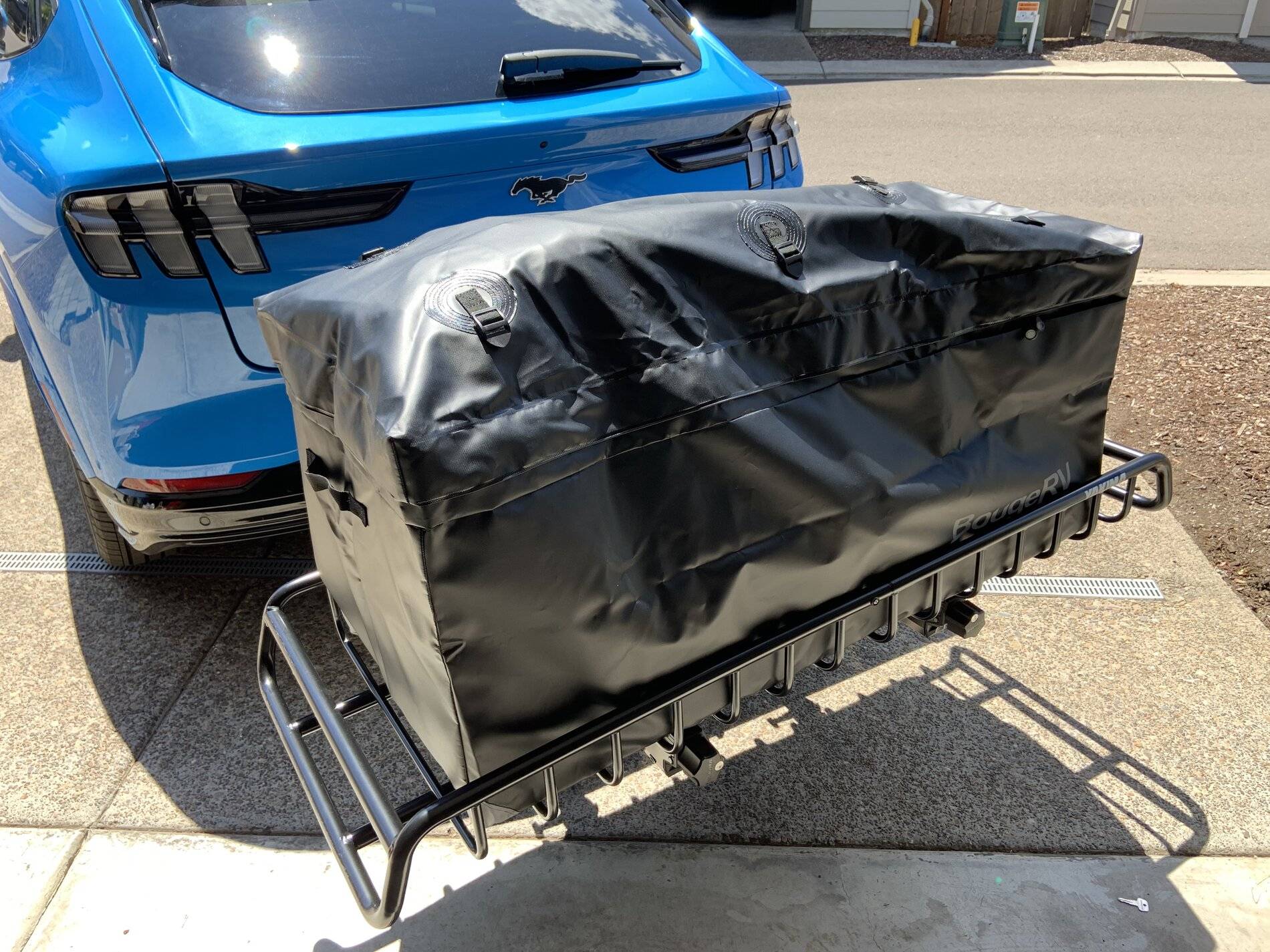

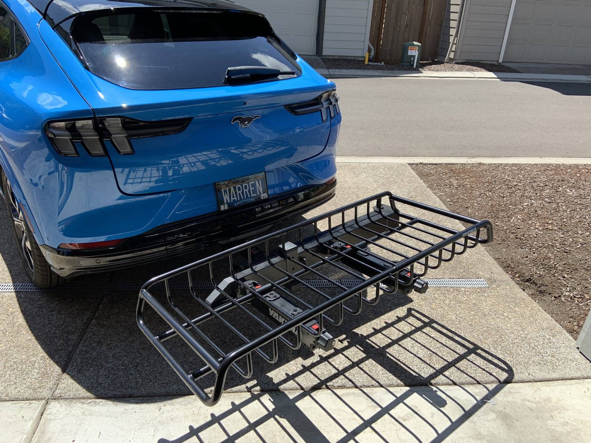

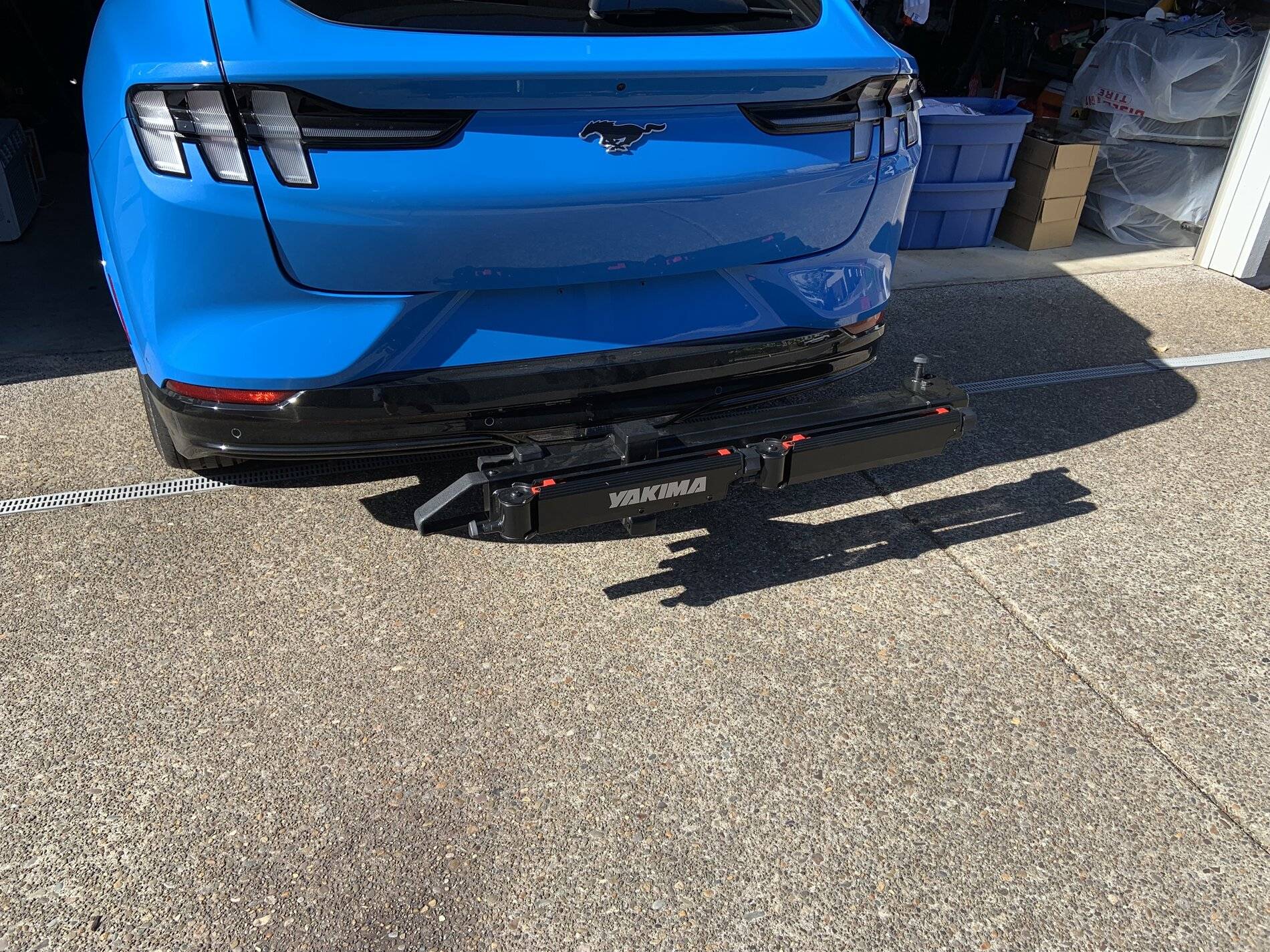

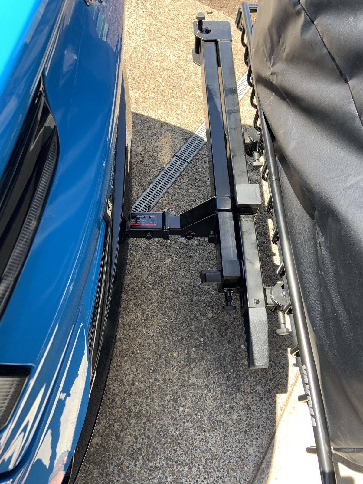

Quick update on this setup. I found out that Yakima makes a 7” hitch extender (StraighShot) to help move the SwingBase further away from the rear and get better clearance.
And expanded with the cargo basket (EXO GearWarrior), and a soft side waterproof cargo bag that just fits in the basket instead of the EXO GearLocker (for now).

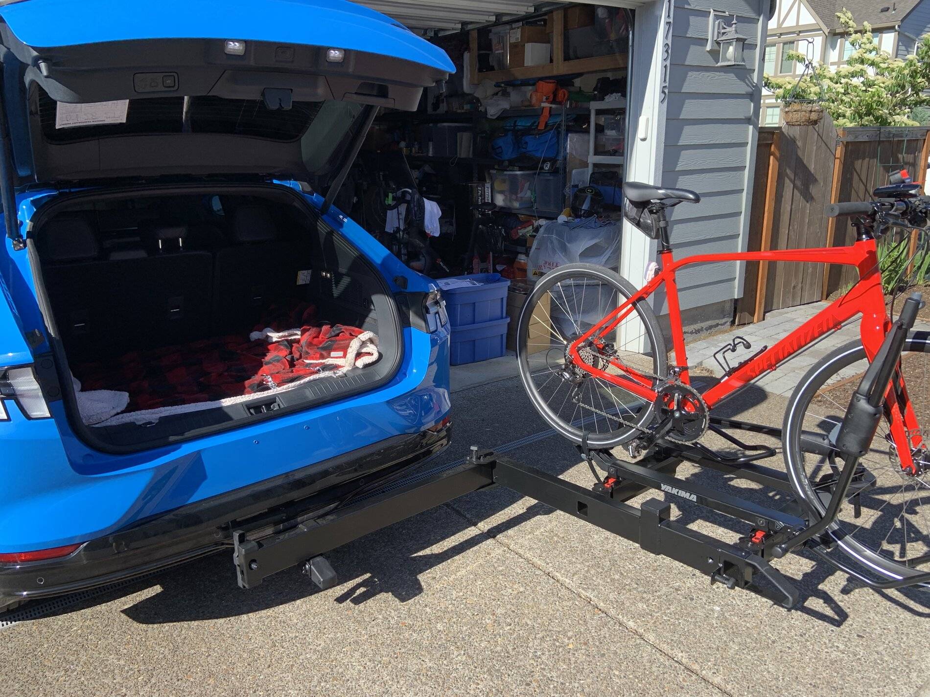

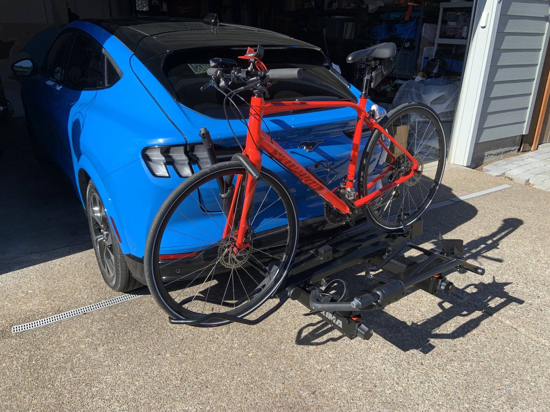

So I went with the Yakima EXO solution. Got the Torklift Ecohitch and installed it yesterday. Here is testing the setup with bike rack only. Will eventually get the cargo box to replace the roof top box, and the EXO Top Shelf so that I’ll be able to carry the bikes and cargo box at same time from the hitch.
