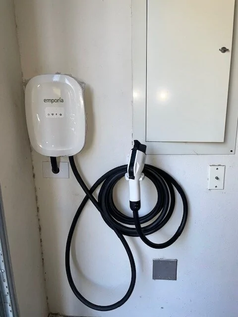

The Ford Charge Station Pro can derate to 40A via the internal hardware switch and use a NEMA 14-50 plug/outlet on a 50A breaker.
I have a Lightning and use a 48A L2 charger hard-wired in my garage.
We currently share the charger between my wife's PHEV which charges every day to 100%.
My Lightning gets charged once a week on a weekend.
Hoping to get an MME for the wife but it's look like a 2023 which bums me out due to drop in color choice!

I had a surprise visit from my neighbor who just took delivery of his sweet Ford F-150 Lightning Lariat. This is the first I have seen in the Wild. He had not yet got his charger installed, and was using level 1 at home, and parking at a local University, to use the free level 2.
Our home electrical panels are only 125 amp service. He would need an expensive upgrade to be able to realize the full 80 amp charging, and the vehicle to home that the Lightning is capable of. He expressed that he didn’t need that sort of capability. I recommended a DCC load shed device that I had installed for my EV charger. With this device, he can run his charger dialed down to 48amps, on his existing 125 amp panel. I have attached the link in hopes it might help others.
https://dccelectric.com/
When we got quotes for EV charging installs over a year ago, one of the electricians INSISTED we had to have this device even though we had 200 amp service. The inspector said "nope". The electrician called the inspector and finally agreed we did not have to.
Similarly, we're putting in a whole house generator. One option was a smaller unit "to save money" but it required 4 "smart modules" that would offload the big loads and bring them in over time. That saved 2.5% over a bigger generator. Thanks, but no thanks, we went with the bigger generator.
