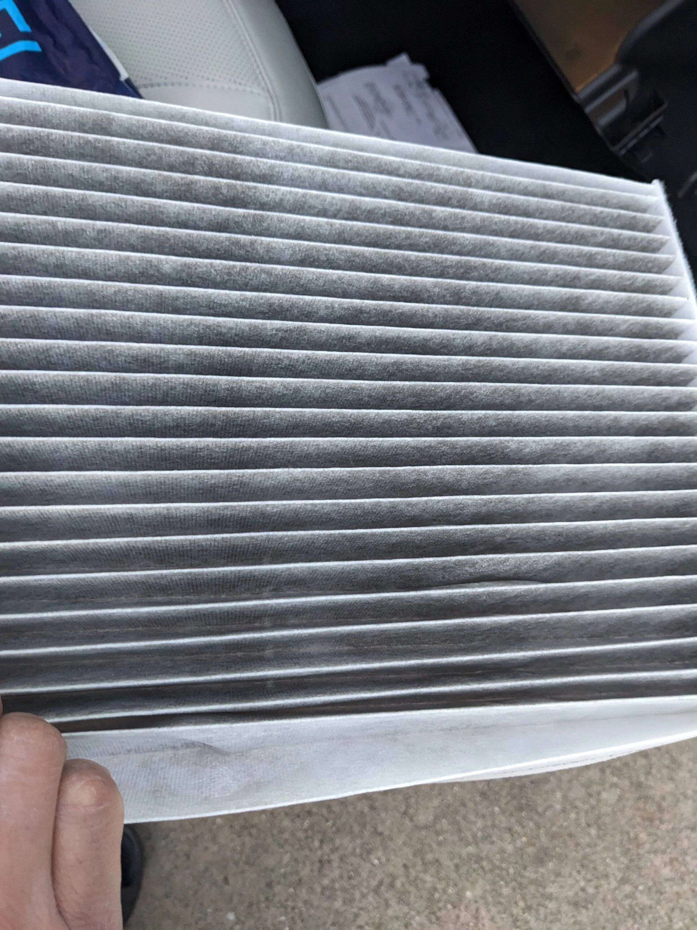

He didn't close the tabs back after shutting the filter door.
I am about to change my air filter now.
Edit: NVM it locks back.
After 11k mi this is what mine looks like.
Ford Mustang Mach-E Cabin Air Filter PXL_20230131_011846876
