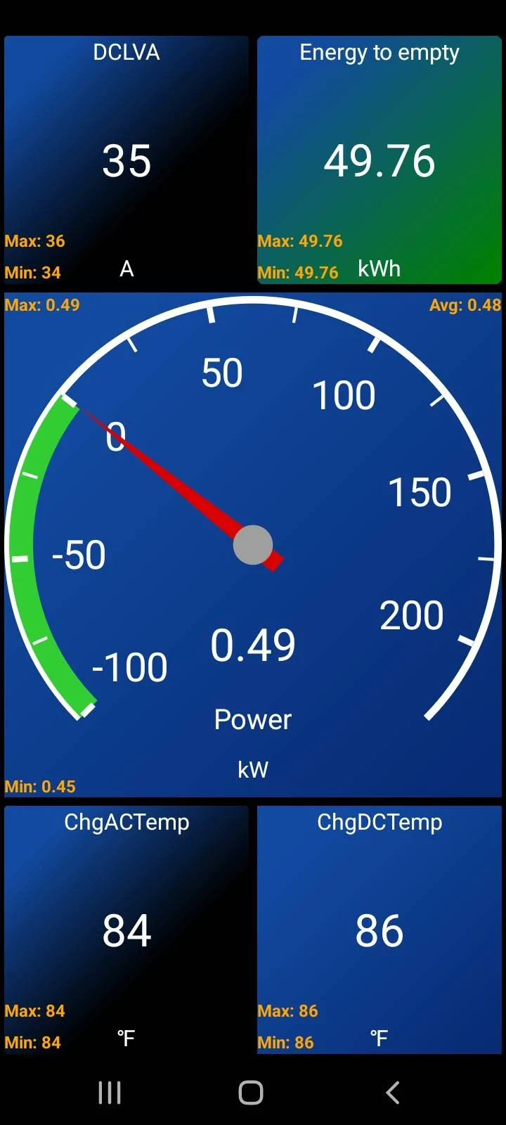

I use unbridled 1-p all the time..... max regen (0% throttle) is about 100 kw of braking.... which is substantial, and could quite likely break traction on a slick road or deep puddle.
If you are in 1-pd and lose traction, you do NOT want to lift foot off throttle completely, you should lift *slightly* to create zero or light braking... It's a big difference from ICE training, and takes a while to change habits.
Once you get used to it.... 1-p is great on snow, ice and wet because you don't lose the time to move your foot from throtle to brake pedal. When I am in snow, ice, or monsoon rain, I usually have my phone displaying CarScanner dashboard display to I can SEE my output/regen power in kw and find zero/gentle braking as needed. this is one of the primary reasons I wanted to be able to see output/regen power (in kw for accuracy) on the dashboard. Since Ford didn't put it on the instrument panel, I put it up on CarScanner Display when I'm driving in bad conditions especially.

another screen to look at in tough conditions. Ha, I’ll pass. But point taken.

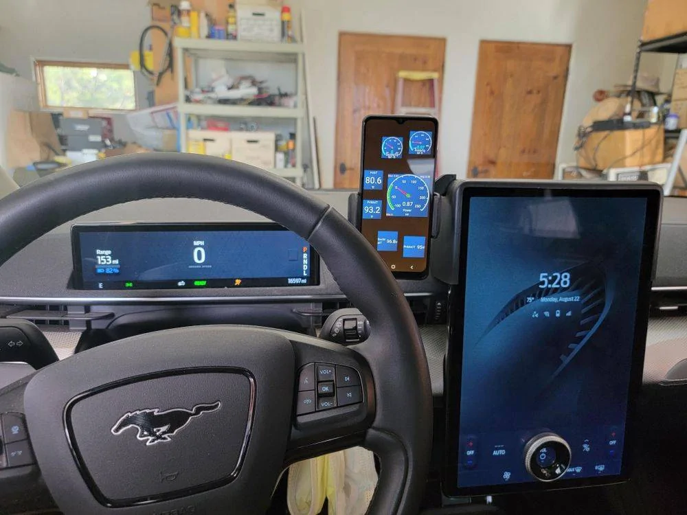

The kW dial is pretty easy to see out of the corner of the eye since I have it mounted at eye level just to the right of steering wheel. This image was taken with an early dial layout I was trying.... I ended up preferring the larger display of kW as shown in previous post.
Ford Mustang Mach-E Can One-Pedal Driving induce hydroplaning? 12 displaying CarScanner dashboard
In So Cal, driving defensively means watching out for the lunatic next to you…like the truck whipping by me. I had my carscanner running while parked and a local police office walked by. He said nice car and I was showing him around the car but he reminded me that if my phone is running and in my line of sight I would probably get pulled over. he said a map is ok but anyything deemed a distraction could be an issue. He noticed my tinted windows but said he would be ok with them. Another officer, maybe not. He was being pretty chill. Not sure if running car scanner while driving is legal, but I’d rather not get pulled over.
