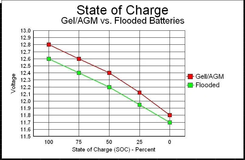

What is a healthy / optimal voltage range for the AGM, to know that it’s not too close to cutoff?
What is the voltage of a 12V battery in a car?
Most 12V circuits (not cars) will operate fine down to around 10V and have protection at 12.5–13V. In a car 12V is dead, a “12V” lead-acid battery should be above 12.5V at rest. Running cars have alternator voltage regulators set between 13.5 and 16V. 10.5V is a destroyed battery for a normal (not deep-cycle) automotive battery.

jgdarden.com/batteryfaq/SoC.xls
This is a good starting point, but it's a little misleading with the MME because if there's any load on the system (like the frunk light), it will measure pretty low. And even at rest with no load, the voltage seems to get pretty low before the DC/DC converter kicks in, so low voltage alone doesn't necessarily mean the battery is unhealthy.
