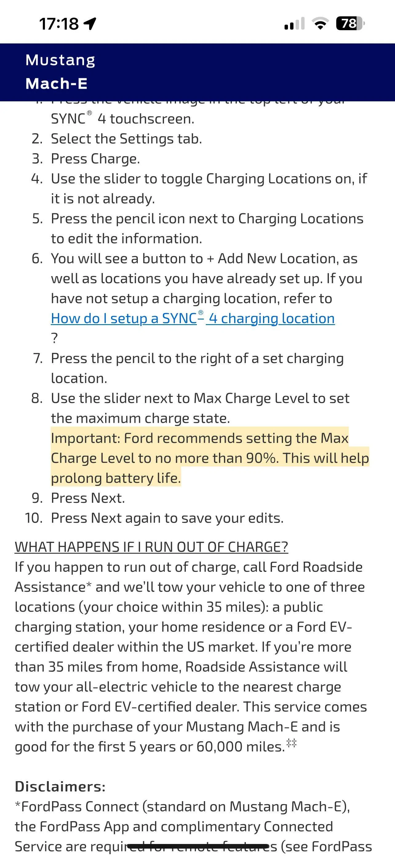

Looking for the 90% charge limit recommendation as I remember seeing it somewhere. Now though, when looking in the manual I see this:
Overnight Charging
You can increase the longevity and performance of your high voltage battery by using the charge scheduling and departure and comfort settings on your touchscreen or in the FordPass app.
With charge scheduling, you can improve the high voltage battery's longevity by delaying the start of charging and setting a maximum charging limit. Set your preferred charging times to be at least 2-3 hours after your typical plug in time. This allows the battery to cool before charging begins. Additionally, setting the maximum charge level to be less than 100% for everyday usage reduces strain on the battery.
Seems all other manufacturers recommend charging to 80%, but Ford did say 90%. Now they say "eh, just don't charge to 100% every day, we think". ?
Anyone else kinda confused by this?
This is what is in the manual that I downloaded when I purchased our car.
Overnight Charging
With Charge Scheduling you can improve
a maximum charging limit. It is
recommended to set your preferred
level to 90% for everyday usage reduces

The manual for 2021 Job 1 cars said 90%. For Job 2, Ford changed it to ā€œless than 100%ā€. Then for 2022 they changed it back to 90%.

To answer your actual question, my 2023 manual says this in the ā€œpreserving your high voltage batteryā€ section:
ā€œExtended Range Nickel Cobalt Manganese (NCM) Batteries
Set your preferred charging times to be at least 2-3 hours after your typical plug in time. This allows the battery to cool before charging begins. Additionally, setting the maximum charge level to 90% for everyday usage reduces strain on the battery.ā€
Nickle Cobalt batteries are DIFFERANT than lithium Ion batteries. They have differant charge requirements. My understanding higher state of charge 100% vs 80% with less degradation and more power density. So could it depend on battery type? Or how Ford set up buffer? Or both?
