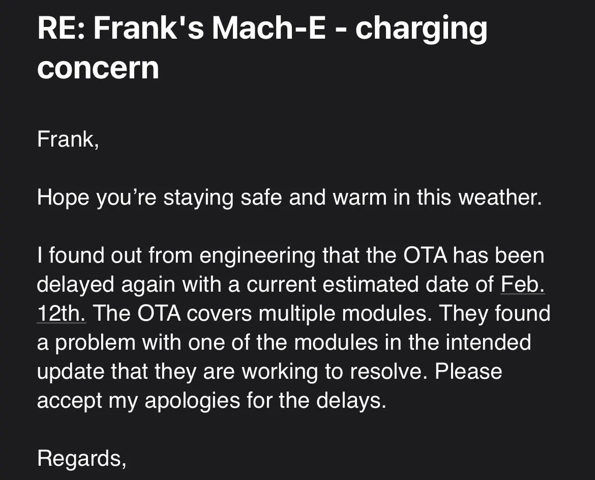

So I talked to someone on the BEV team today after trying to get an update from my other rep who went MIA after our initial contact in early October.
Apparently they had escalated my case in DEcember and assigned a new case number.
Case notes indicate OTA hasn't been released yet (I think we pretty much figured that out now) but that it was due end of January. We shall see.
I did hear there were some issues with the other components of this OTA and why the delay from first of Jan to end of Jan. Also, he didn't have the number/name of the OTA which I would like to have gotten.

It has to be about the fourth date I’ve been told now. ??‍♂

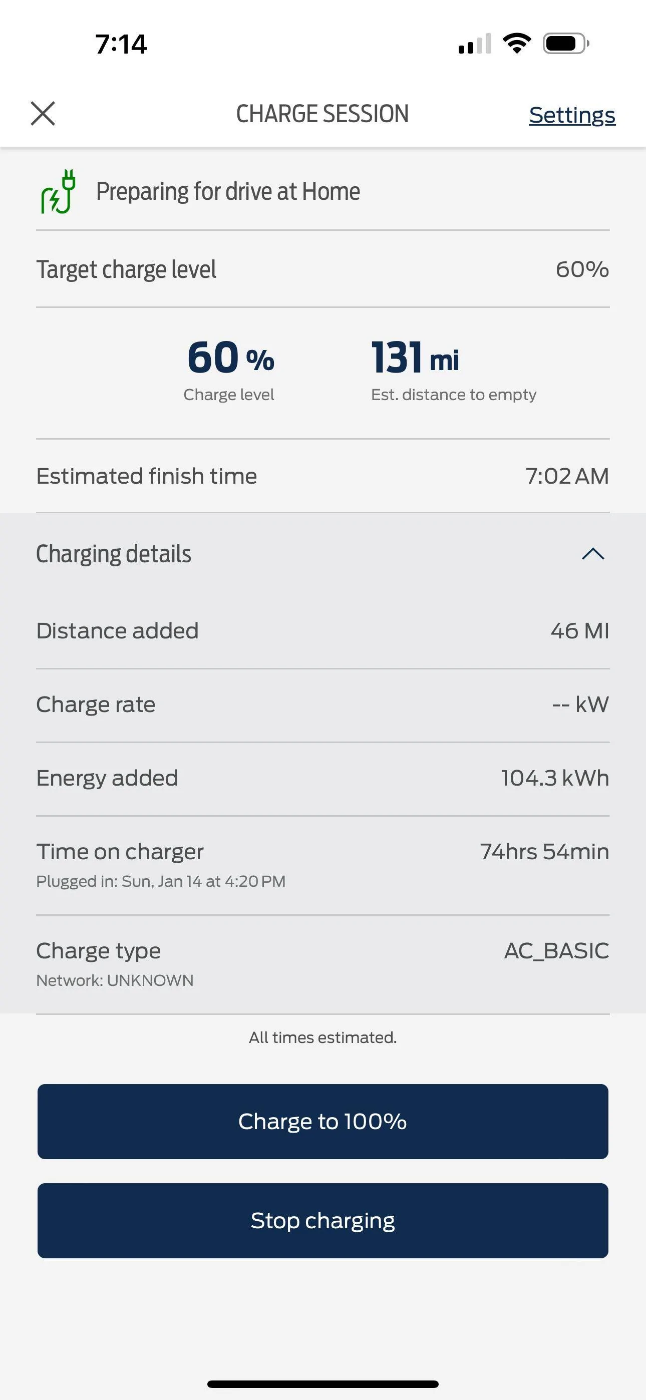

I have a 23.5 gt. Built 9/23. Don’t think I am a candidate for the related TSB about no level 1 charging. Just found this thread. Wondering why my ford mobile evse on a 50amp light was always flashing blue after reaching the target charging level and the blue oval lights never turn white unless I unplug it. Thought it was just because it was near freezing outside. Cry… Cars been plugged in all week. Can I send my elevated electric bill to Farley for payment?
Ford Mustang Mach-E Charging issue IMG_5040

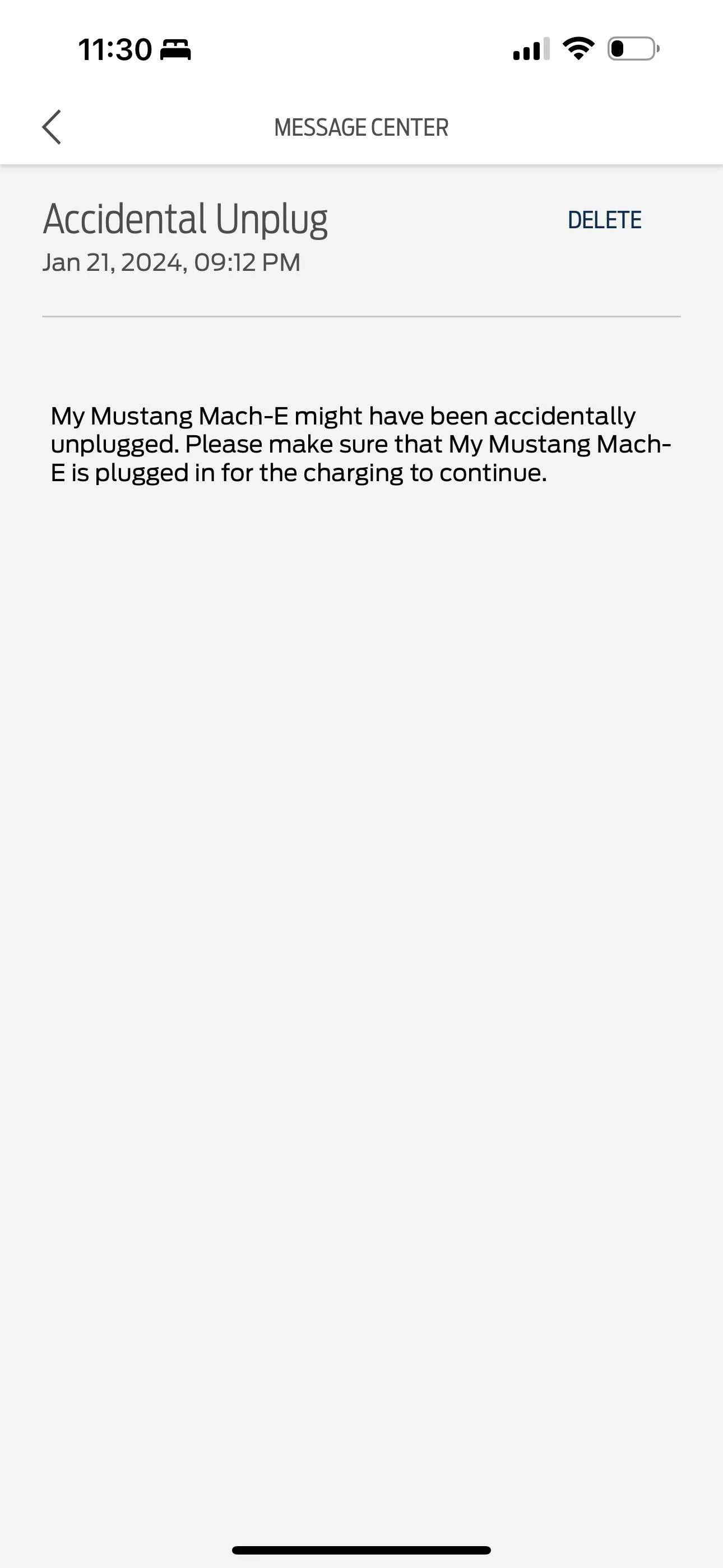

ooh it gets better. Proof it was charging. I got notified that the evse was unplugged while it was charging even though it reached its target charging level.
Ford Mustang Mach-E Charging issue IMG_5064

Does the humming cooling pump turn off when your car gets to the goal charge? I can't tell if electricity is actually being used when the blue lights continue flashing but the goal charge is reached and the pump finally turns off.
Others have said that there is a separate FordPass bug, so it's possible that electricity isn't actually being drawn after the goal state of charge is reached. The only charger I have is the Ford mobile charger so I can't test whether power is actually be drawn.

I could hear something note sure if it was a fan or what. It was not the loud humming sound. Ford pass continues to add 6 kWh on my ford mobile charger calculation but the draw is a dash. I added my FordPass screenshot as evidence to my previous post.

when the car is charging it has a distiinctive hum on the front right side of the car. And also the circular lights at the charge port are blue and on. On most of our cars which all seem to be 23s, that sound and light continues after charge level reached unless manually hit "stop charging" on fordpass or pull the plug. When it reaches threshold percent I don't think it's actually still adding kw to the battery as theoretically it would overload. I think ford just mindlessly adds the kwh at whatever rate it WAS charging at. BTW, a person from the BEV team specifically told me the car is not adding kw to the battery once it reaches target threshold.

The one thing that seems slightly different about my car is that the hum stops when it gets to the goal state of charge. The charge port continues to flash blue, however. ?‍♂
