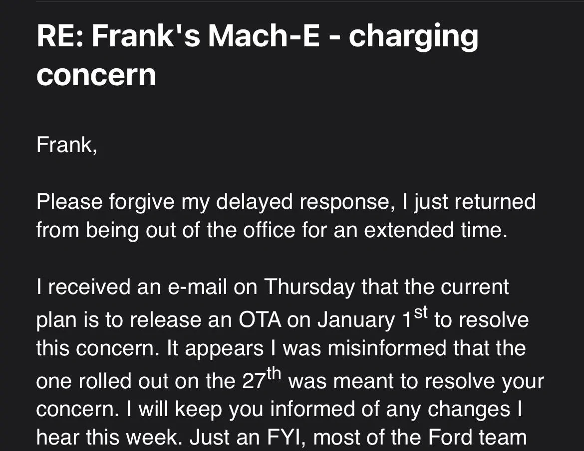

Here is what I was told. I have yet to see it come my way. ??‍♂
Ford Mustang Mach-E Charging issue IMG_1111
Rolled out on the 27th, assume he means Dec 27th? I'm going to hang out until end of January. then I'll take the next step if nothing done.
That was actually Nov 27, the last date I was told it was coming.
