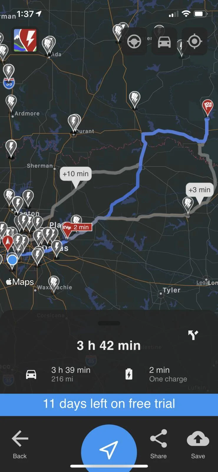

Going from Fort Worth to Broken Bow.
To me it looks like, if you stop at Mt. Pleasant, you add 3 minutes to the trip but have an EA 300 kW charger. Would show up with maybe a 50% charge.
Thanks guys for pointing that out. Going that route adds minimal time. I can top off significantly and won't need to add much via 110 when I get to the cabin. I decided I'm just going to buy a high quality, 12g, 50ft extension cord and that should be sufficient. I'm make sure to test it out before I get on the road.
