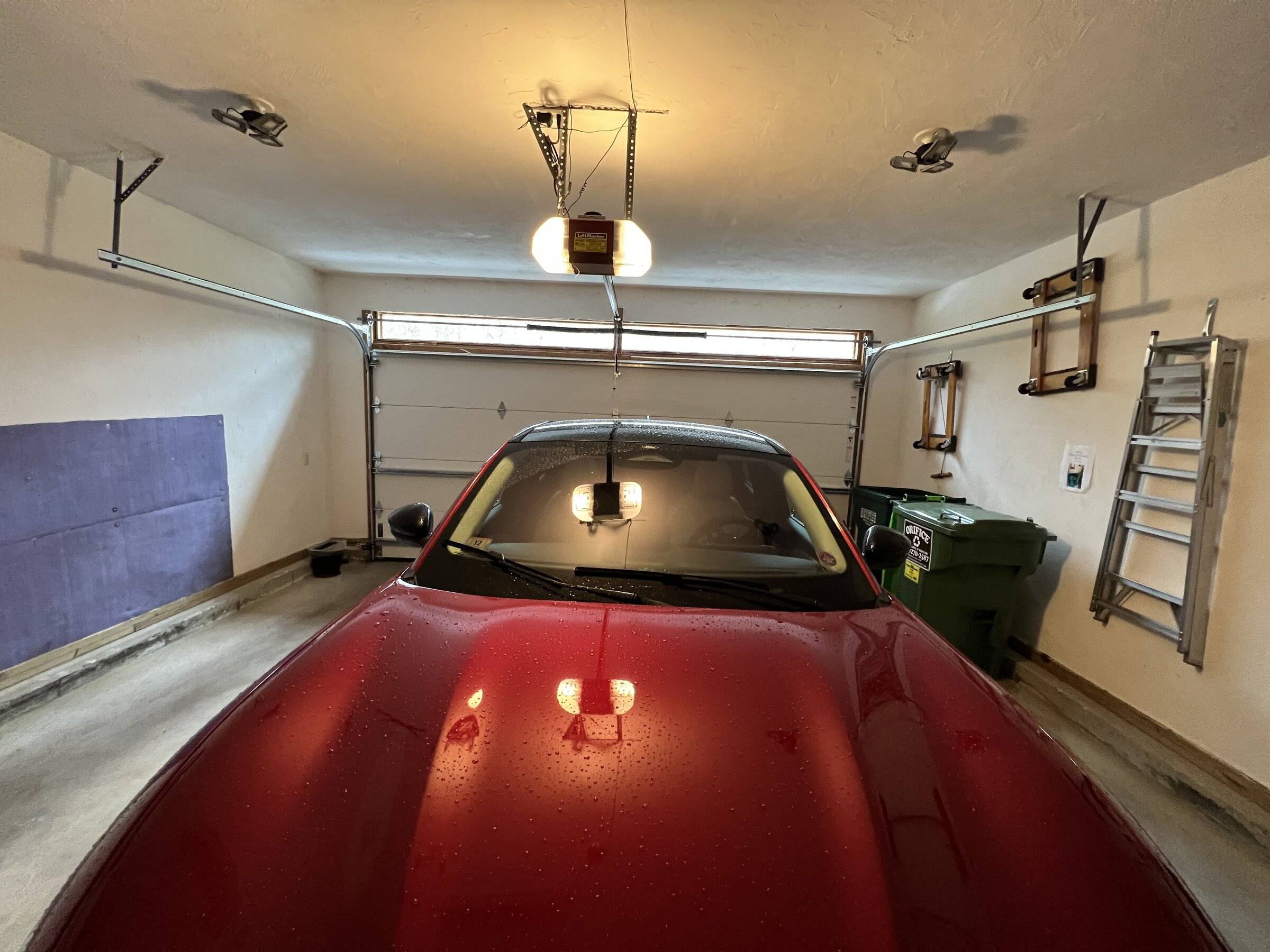

My problem with mounting at the center of the ceiling is what to do with the cable when it’s not in use. My garage has no dividers in the center, just a big open space.
I saw a reference to a tool balance, but with 24’ of cable I don’t see how that could work.
picture of the location?

what if you just mounted the whole setup right next to the Ladder or on the wall with the ladder? (or I’m missing something)
mine is hanging from the center of the garage between the 2 bays.

Not sure why you need extension; however, Mounting a 240 V outlet on the wall near the dolly by garage door would give you enough distance for both garage charging and outdoor charging with garage door open.

My original question about extension cords stemmed from my desire NOT to spend the money and/or time to relocate the existing outlet, which is on the wall against which I was standing when I took the picture above. My idea was to make one of the two cables long enough to rise to the ceiling, and traverse it to reach the wall on which you see the ladder. (Going horizontally is not an option because there are stairs and a door in the corner between the adjacent walls. )
As we’ve been very helpfully discussing this over the last few days I’m warming to the idea of biting the bullet and paying an electrician to move the outlet.
