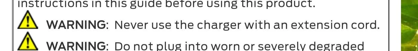

Someone needs to point this out : the official instructions say to never use an extension cord, full stop. From the online manual just now :
Ford Mustang Mach-E Will My Extension Cord Work? Screenshot_20220318-214151
You can do what your want, and I was successful with charging my Fusion Energi with an appropriate AC extension cord even though that mobile charger said not to for safety reasons... (in fact, the first one was recalled and replaced due to overheating that would melt extension cords)
A J-1772 extension as some as mentioned "feels" a lot safer to me, but that is still an extension cord of a sort.
