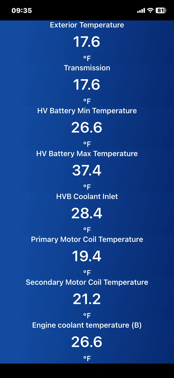

The dealer repaired the car last week by replacing part number L1MZ 18E254 A, which according to Google is the PTC. Heat has worked well since the repair. Traveled to Lake Placid, NY and home (about 5hrs round trip) in subzero Farhenheit temperatures last weekend. We monitored the heater using the car scanner during preconditioning per for leaving. Continued to monitor while traveling and then while dc fast charging. Very interesting how the car manages heat in all of these situations. At home we keep the car connected to the charger. We do not have a garage. The car now regularly (about every 6hrs or so) draws a little power to keep the battery happy. It all seems to be working as expected. Thank you to all who helped and shared.
