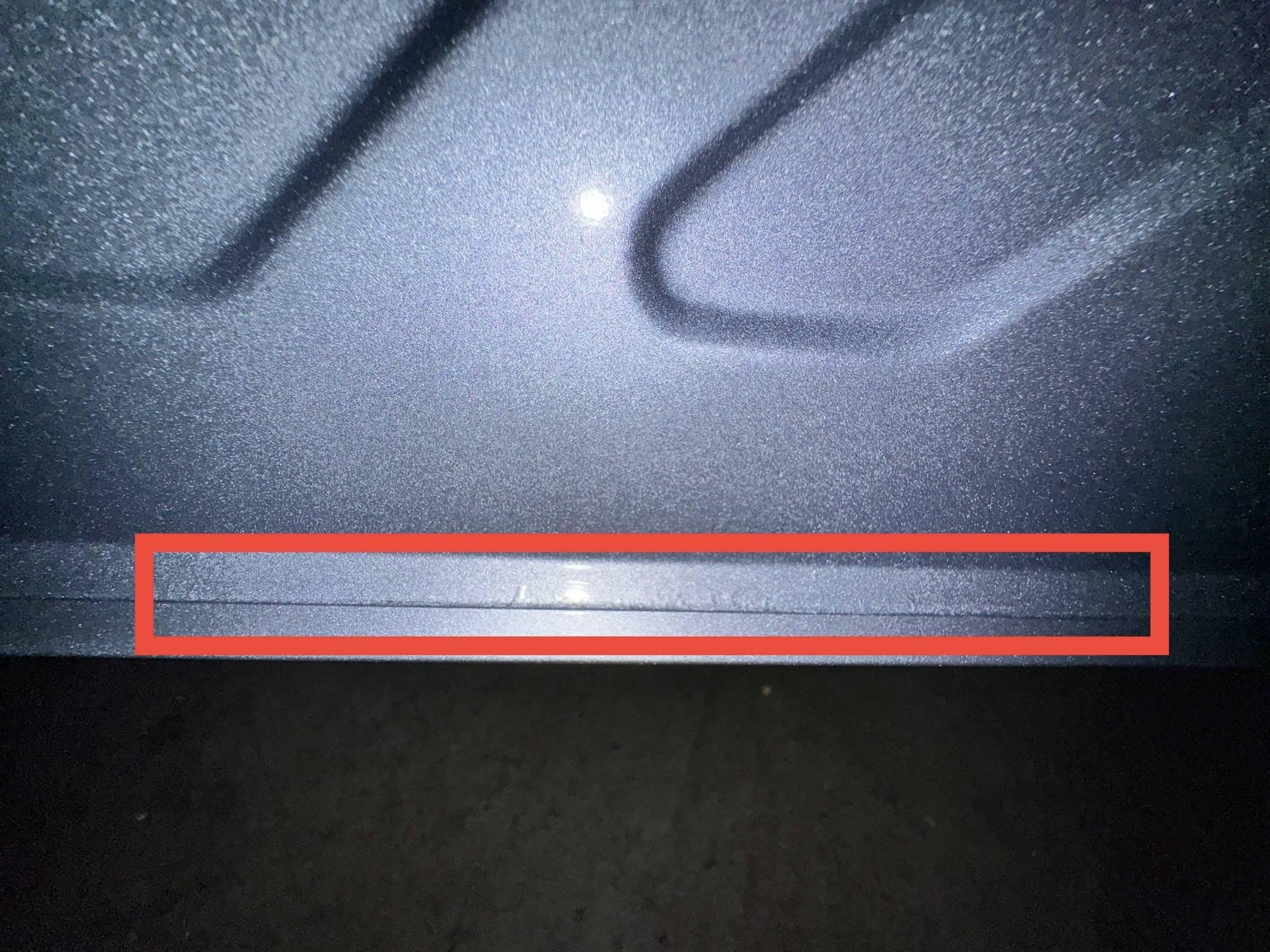

I checked the door hems on my 2022 Mach E. I found the defect on the front passenger door ?.
Ford Mustang Mach-E Customer Satisfaction Program 24N05 - Door Hems Paint Sealant Issues 1718475474498-ny
I’m still debating if I should take it to the dealership to get it fixed. The Ford dealership where I picked up my car has some bad reviews with their service department.
