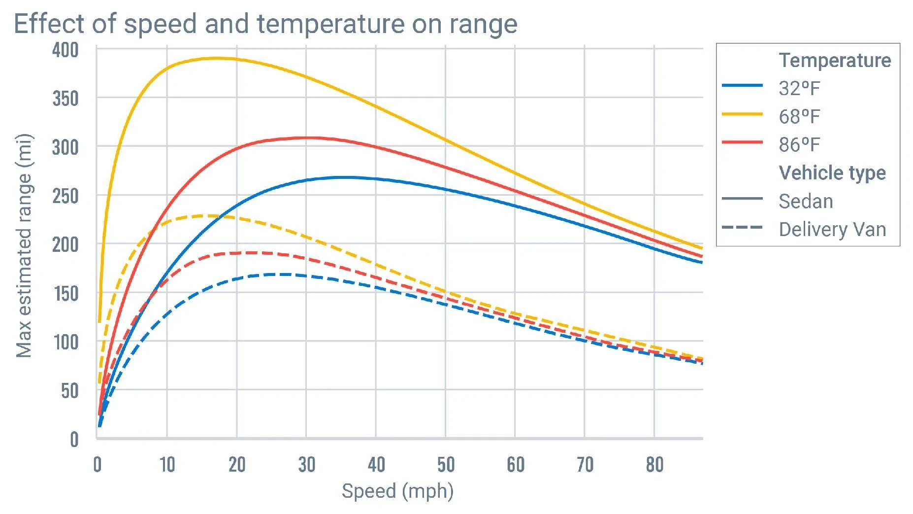

Let me clarify my last post about this here since "omg speed" comes up on this board all the time. This way I have something to reference in future arguments :p
The issue with range for most EV owners is knowing what your constant is. The things we can't change and things we don't plan for are what get us in a pickle. If you decide to travel 10mph faster, that's a constant. You can plan for that. You can't however change the temperature, headwinds etc. Starting a drive with relatively calm winds, that change to strong headwinds can get you in trouble. This is due to drag, which is the same thing that increases with speed, but it's something you can't plan for as easily.
Assuming we are traveling long distance:
Facts:
- Speed will decrease your range by about 10% per 10 mph
- Optimal speed is 19mph (for all you "don't speed people")
- Range is mostly considered on long trips, not city driving
- 1pd vs 2pd on highway traveling makes no difference
- Drive modes make no difference
If we take a scenario of driving 70mph in 68F weather in an MME we will be able to drive 238 miles in 3h:24m.
If we take a scenario of driving 80mph in 68F weather in an MME we will be able to drive 209 miles in 2h:36m.
This makes for a difference of 29 miles and 48 minutes. At 80mph we can cover those 29 miles in 21 minutes.
Assuming, however, that both must stop to charge at the same station. The 80mph vehicle must DCFC for ~15kW more than the same vehicle arriving at the same charger that went 70mph, and would have to stay approximately 9 minutes longer if 100kw is being delivered via the charge unit. This will also result in an added cost of about $5, unless it's a free charge day!
The end result is a quicker arrival time at the expense of a little more energy ($) and slightly longer stops for charging. Obviously, if our goal was to get 225 miles, the slower vehicle would get there without the need to stop assuming perfect static environmental conditions. Even so, the same distance at 80mph would take 24 minutes less allowing for a quick top off of electrons which would probably get both vehicles to the same destination at the same time.
So, to recap - what is your goal? Is it to get there quickly? Or, is it to get as far as you can go without stopping? Most of the time we plan our routes and we leave 30-50ish miles as a buffer, mostly because chargers are sparse and conditions can change.
It all comes down to your comfort. I'm in my late 30's and I'm hyper. I want to get there as quick as possible. There's a lot of retired folk on this board that need to drain their bladder and walk their football sized ankle biters every 30 minutes (or refresh their knowledge of the owners manual) and don't care when they arrive.
To each their own, but in the grand scheme of things, as I said previously, drive the car however you want to drive the car and don't let people sow fear into how you're most comfortable driving. The facts have been laid out for you to make your own choices.
