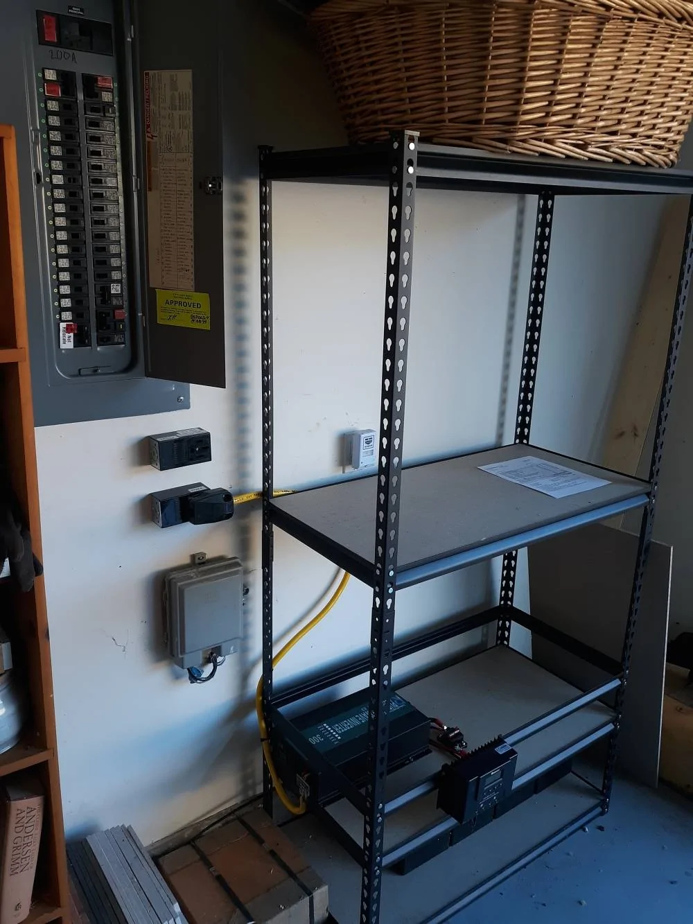

Or, you could add a few stationary batteries to stay at home and cover the time you are out. The 'basic' system I've been putting in for people has 4kWhr per shelf, and 1,2, or 3 shelves of batteries to stay home.... then, custom 'jumper cables' when the MME is home to put in parallel by jumpering from MME 12v connection points to backstop/charge the stationary batteries.
Keep in mind a couple things:
- you MUST be isolated from the grid (Main = off) before using any Generator
- you must also turn off existing grid-tie PV since the grid-tied inverters should NOT be active
- you will have to turn MME on, and the setting for auto-off will have to = OFF so that the 12v system is held at 14+ volts by the HV->dc-dc converter.
- max load *should not* exceed 2000 watts to be nice to the dc-dc converter topping up the stationary batteries as fast as you are using the energy

your MME is only a POSSIBLE giant backup to a small (affordable) Solar 'generator' for multi-day outages..... if you have an auto-transfer already installed, its not hard to design a little battery based 'generator' instead of a propane/NG generator.
I think EVs are the ultimate solution for double use of a LOT of available Energy for backup without having to buy a whole separate battery bank that you rarely use.
I.e. design the backup system around a small (4,6,or maybe 8kWhr) to keep cost down.... knowing you likely have access to 60-100kWhr from your EV via the 12v connection points. Just 'jump' the stationary battery rack if it gets low. connecting your MME 12v connection points to the BBU will pull maybe 40 amps or so (14.5volts at MME -> 12.x v) and 'support' the little BBU.
