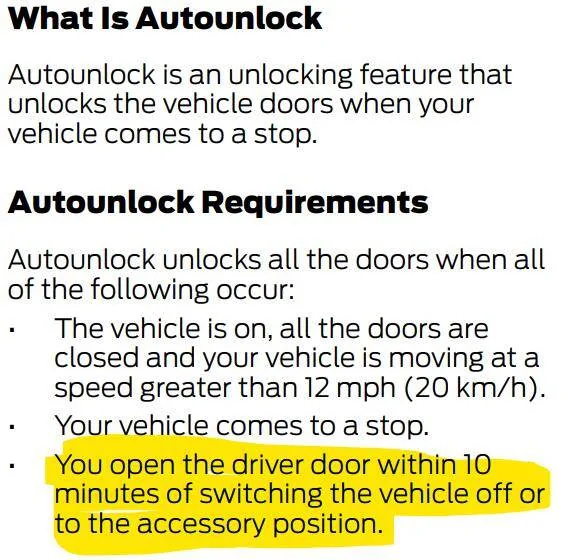

It took me about 13 seconds to Google for this:
Ford Mustang Mach-E Disable Auto Lock when driving? 1623590906531

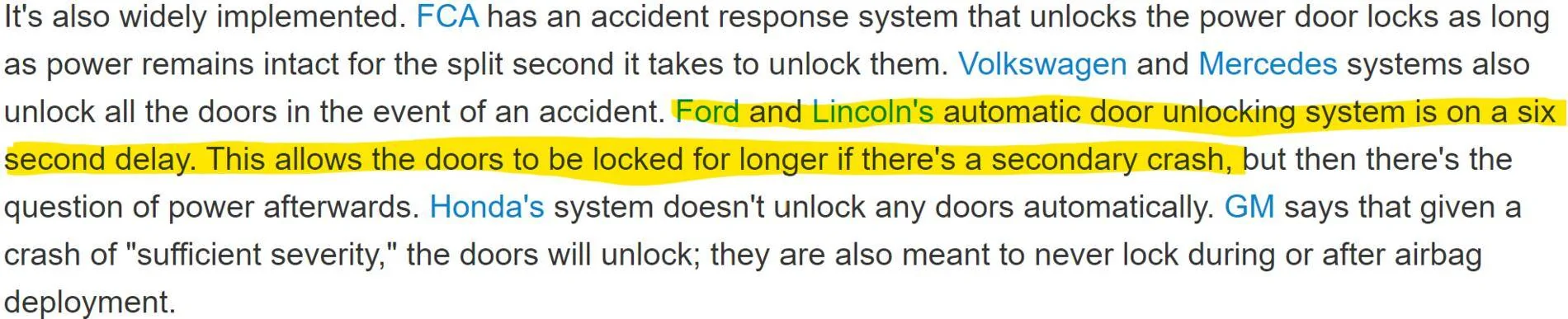

Also, https://www.cartalk.com/content/today-how-do-locked-doors-help-during-crash
And finally, here's how different car makes react during a crash:
Ford Mustang Mach-E Disable Auto Lock when driving? 1623591370025
Given that we haven't heard much about autolocking issues during crashes, I suspect the benefits outweigh the downsides?
As far as safety goes, I can tell you that here in Chicago, carjacking is a very real thing. Yes, doors don't lock automatically as soon as you get in (which is when a carjacking is most likely to happen), but I think autolocking provides a crucial additional benefit.

The auto-lock is turned on after you go above 12 mph. Let me understand, in your area you have criminals that run faster than 12 mph and then jump in your car ?
In any case, it should be my choice to have or not.
Here's a typical case: I go to the get the car and drive around the block to pick up my wife, I stop, forget to hit the unlock button, and she (rightly) starts cursing because the door is locked. In the previous two cars I owned I was could disable this "feature", the cars I owned before that didn't have it at all.
Have you tried putting the car in Park before she tries to get in?
He would have to put it in park, shut the car off, and open his door. ALL of those things have to happen before the Ford system will auto-unlock the doors.
