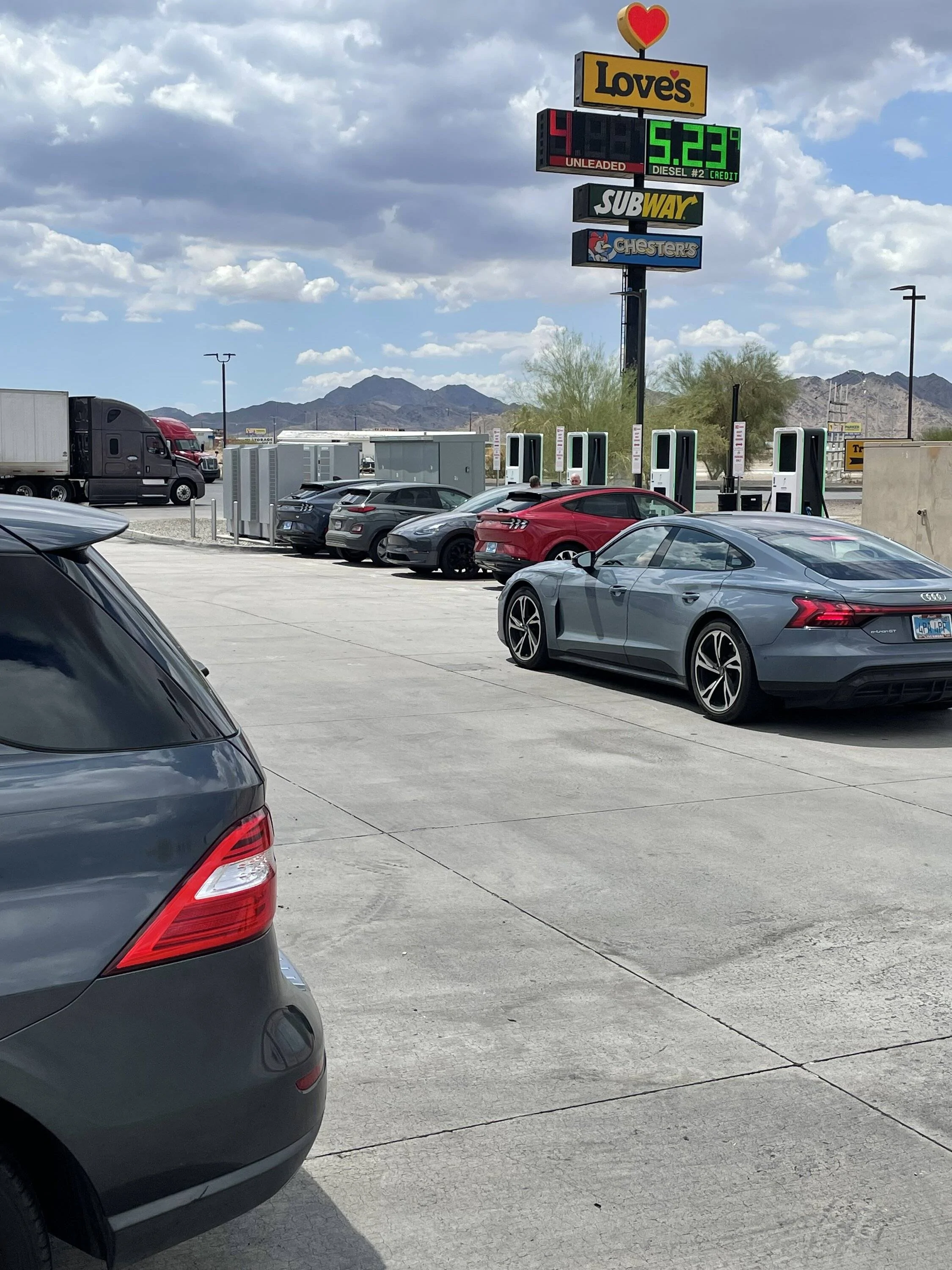

Which Loves is that?
Quartzsite Arizona, along I-10. I also charged in Indio, CA, just before that stop and it was full, including this Lightning. There was a Niro waiting when I unplugged at that stop.
