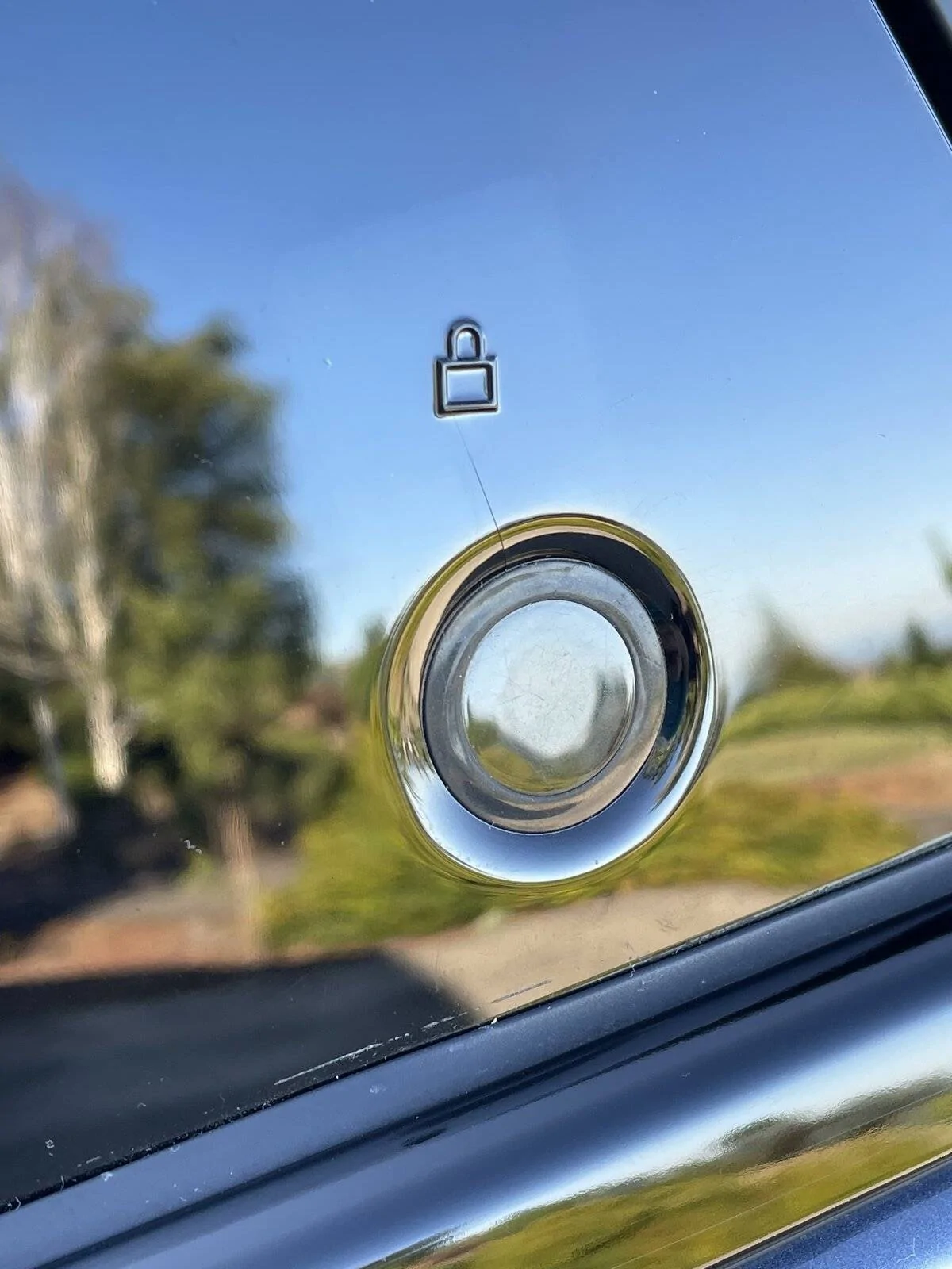

Door Entry button crack
Are you seeing a hairline crack above your door entry button?

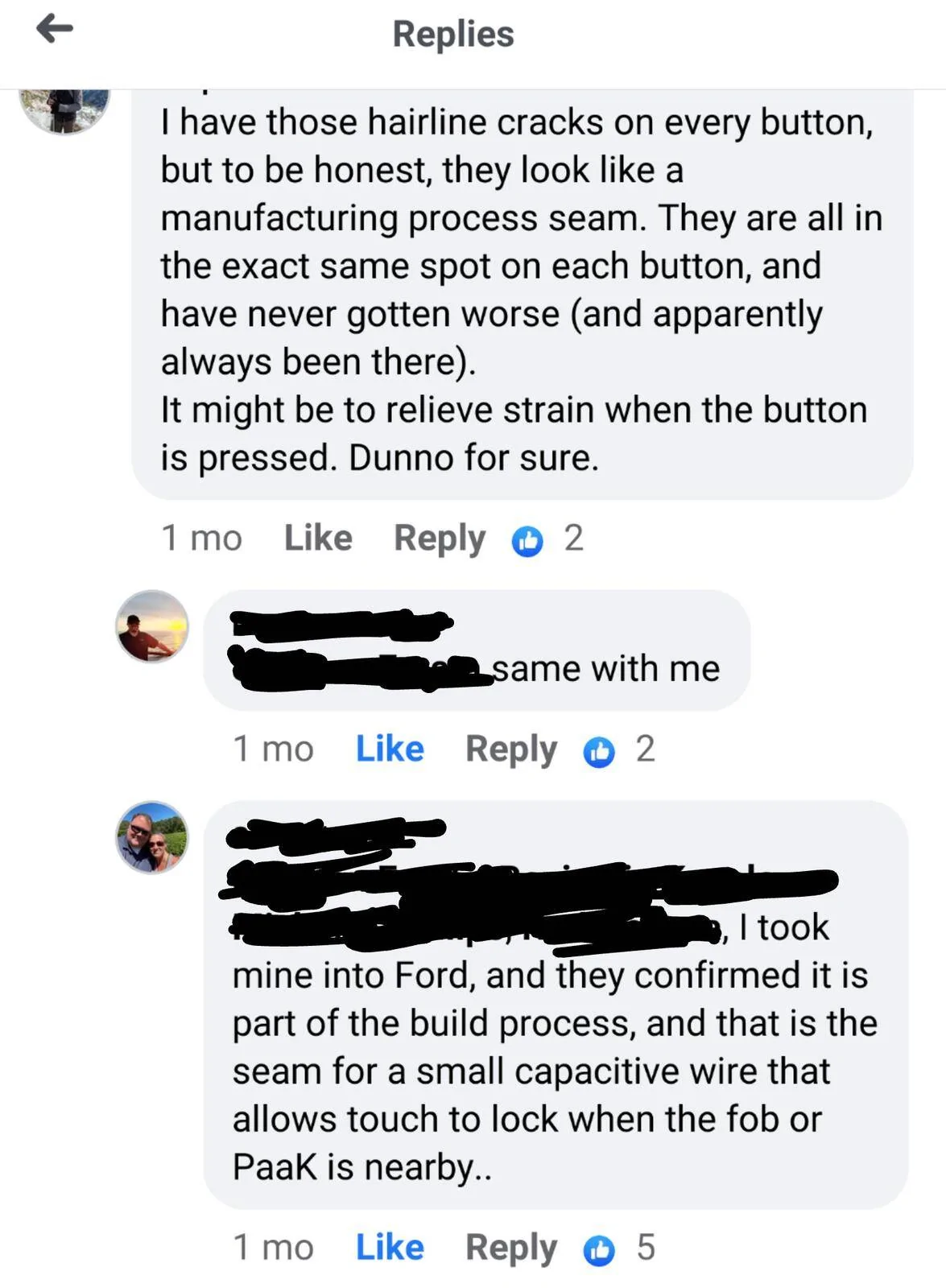

Supposedly these are not cracks. This same discussion was going on on the Facebook group page, until someone weighed in with a Ford Engineer's statement that those "cracks" are actually part of a "capacitive element" for the numpad touch-to-lock feature, when the key fob and PaaK are nearby.
You might notice that every single car has them in the same spots, since new.
EDIT: found the thread on that Facebook group. It's anecdotal, but it is a perspective that might prove true.

Supposedly these are not cracks. This same discussion was going on on the Facebook group page, until someone weighed in with a Ford Engineer's statement that those "cracks" are actually embedded "antennas" for the key fob and PaaK receivers.
I know this is anecdotal, but you'll have to take my word for it. They're a feature, not a defect :)

Because it's a seam. I found the thread in question. They are supposedly actually a capacitive element for operating the touch-to-lock feature on the number pad, when the fob or PaaK is nearby.
I'll update my original post with that info.

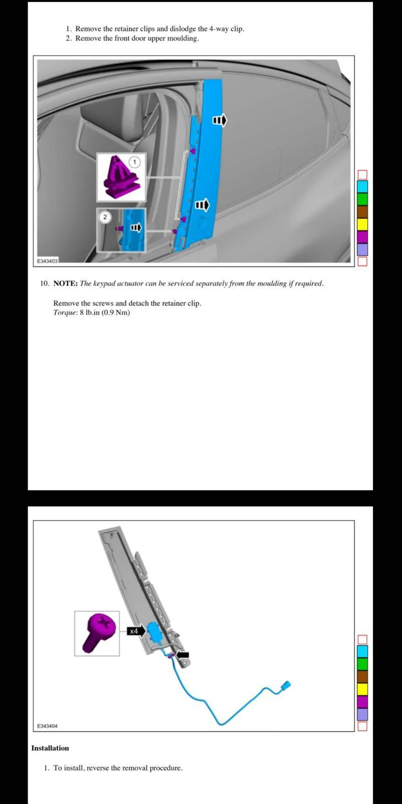

In the WSM, the only mention of this panel is as a complete module as shown:
Ford Mustang Mach-E Door Entry button crack Screenshot_20210625-012738
So no clues there.

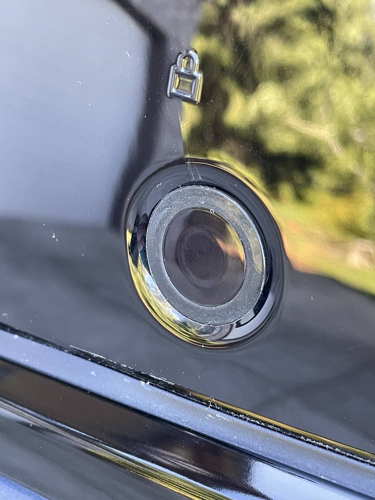

Upon closer inspection of mine, I've concluded they are part of the plastic trim molding and not actual cracks. Probably for what Sockmaister said above. Especially since they are all symmetrical - front doors are both at a slightly angled vertical line from the lock icon down, and the rear doors are both at a sharper vertical line from the lock icon down.
First two photos are of each front door seam, and the bottoms are the rear doors. Sorry for the dust and hopefully you can see the seams. (I swear there is no dust when I'm looking at the car! :confused:)
Yes. I concede! I think @sockmeister and you are right.
I wasn't able to see the hairline on all four doors with my eyesight, but using the phone camera I was able to confirm what you've observed on all four doors.
Agreed! I have them on all four doors in exactly the same positions as you. Any "waviness" observed by others on the cracks I think chalks up to various distortions in the plastic moulding itself.
Also, it's very interesting to note that
a) All the seams were there on my car from delivery day, and
b) suspiciously, they never, ever got any worse, even with daily use.

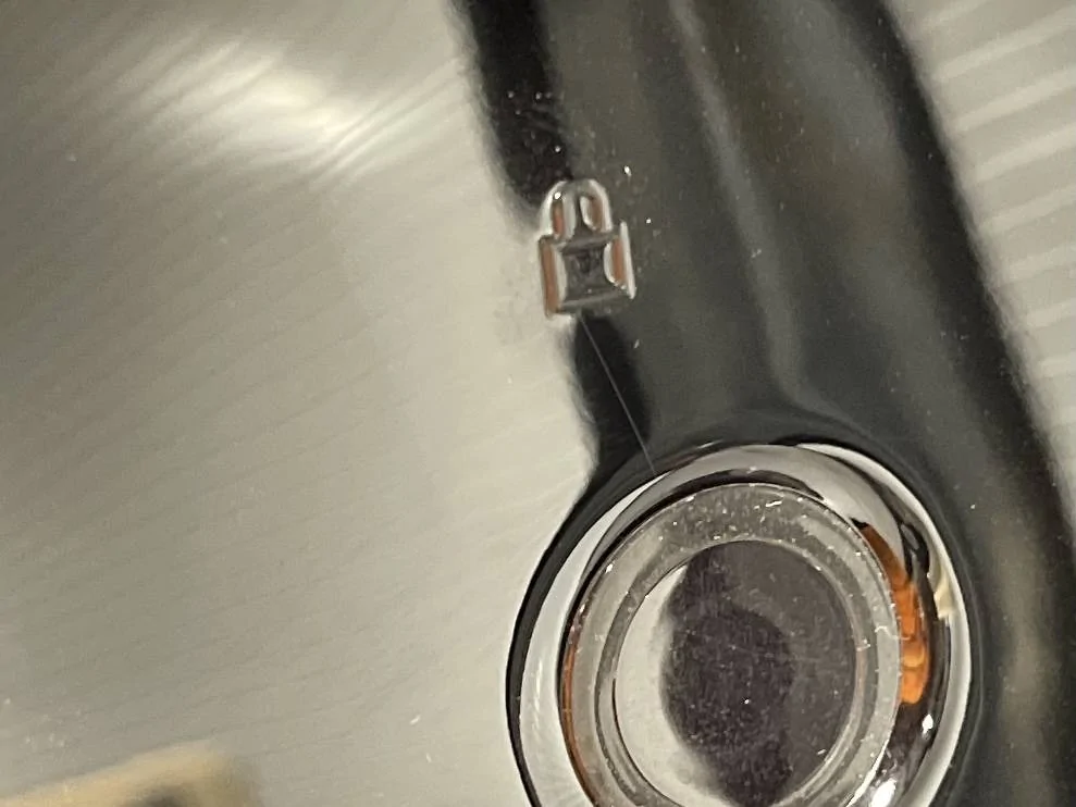

Just saw this today on my car, too. Rear driver’s side (left).
Ford Mustang Mach-E Door Entry button crack 3F26B63C-1CC9-47E4-B360-A9B084F1DBD8
Ford Mustang Mach-E Door Entry button crack FC6AFD1B-F66D-4ECF-BBA8-64E62D76CF26
