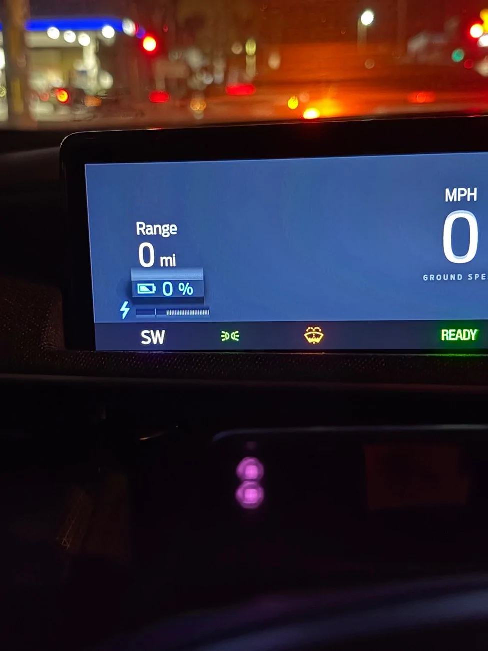

Tonite I went 7 miles and I had 5 miles left until empty on my dash. 2021 GTPE , when I was 4 miles away I had 1 mile left until empty. I went 3.5 miles on 0% essentially to a charger that was rite off the freeway by my house. I had everything and I mean everything off including my headlights on off no AC on and no radio on with screen on rest mode.
