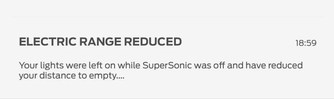

I did look at my phone in the FordPass app, there was a notification (attached).
At first I thought it was an OTA update as the car does act strangely during or after an update, but there are no updates.

You can leave the lights on by turning the headlamp control to ON. But they should turn themselves off after about 30 minutes. (Or 15 minutes? I can't remember. It's in the manual though.)
There is a known issue where the headlamp control might lose its setting and it then fail-safes to ON. If this happens, you can tell because the little light indicating the headlamp control position will not be lit until you turn the dial yourself. To fix this problem, just turn the dial back the Auto position or whatever is your normal preference. There is no permanent fix for this occasional issue, but Ford has said it's working on a replacement for that hardware module.
It's normal for the puddle lamps to turn on for about 20 seconds or so when you first approach the car with a key or PaaK, so nothing weird on that part.
The other thing you mentioned was that your wife saw the inside screen left on. That shouldn't happen. Is it possible you forgot to turn off the car after you parked and left it?

The warning was received because the headlights were on with the car off, which is a bug in the switch.
Rotate the knob to off, then to Auto.
It likely won't occur again for a long period of time.
