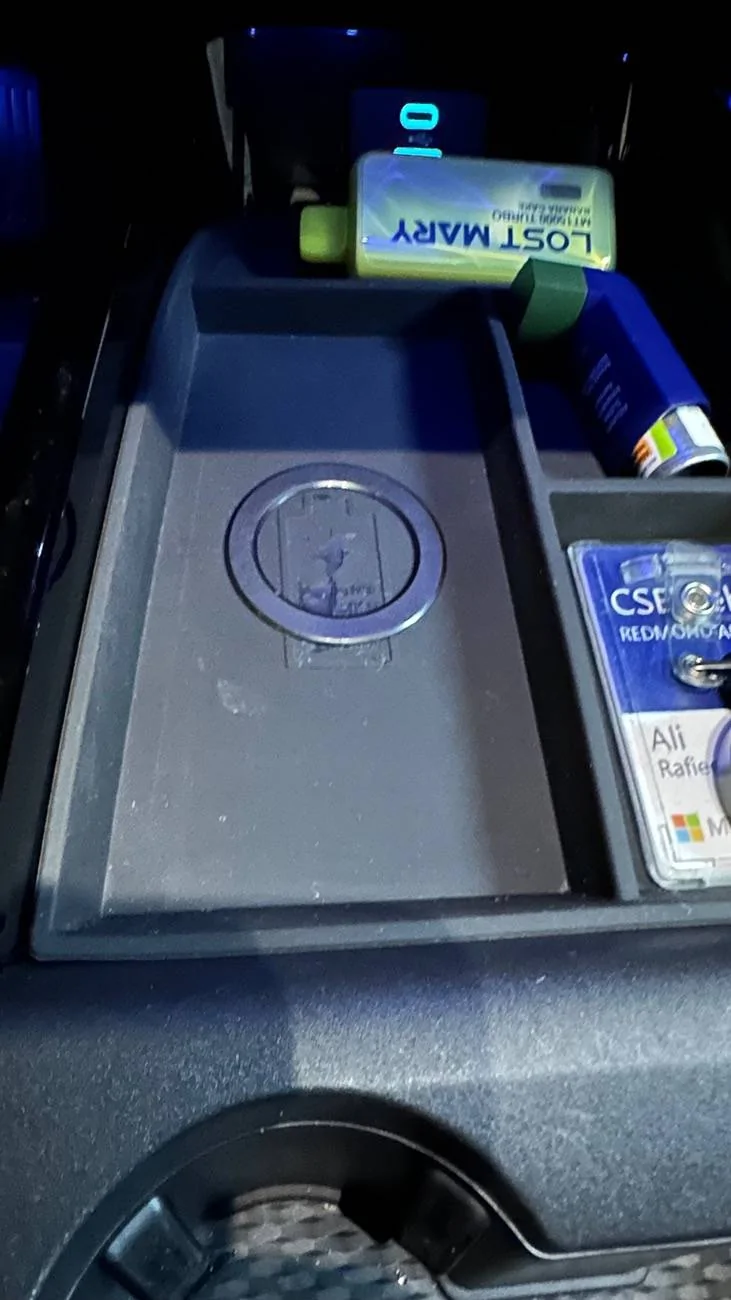

Got done with my setup.
I used these two:
XZC Mag Safe Case Magnet Sticker... https://www.amazon.com/dp/B08Q7XWB85?ref=ppx_pop_mob_ap_share
Magnet Ring Adhesive Compatible... https://www.amazon.com/dp/B09T74CBQV?ref=ppx_pop_mob_ap_share
I gutted the ring (2nd link) and put the magnet sticker in it (1st link)
I shaved off the symbol on the mat and put some super glue on the ring before setting it on the mat and I let it sit with something heavy on it for a while.
It is so strong that it lifts the mat if I pull it straight up.
Here is a pic. The shaving wasn’t that clean, but doesn’t look as bad in person.
