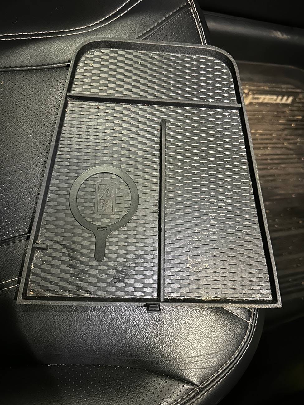

Arrived on the good ship Amazon today.
Stuck one in place, don’t look too bad - see attached piccy.
My ‘phone, an iPhone 14 ProMax, was fully charged so put wifey’s iPhone 11 on the mat and in about 30 mins driving had charged from 62% to 78% and was fairly warm.
That’s more than mine has ever charged without this charge ring - only ever barely held its charge and got so hot until IOS shut down ‘phone to cool down!
Be interesting to test mine on there.
Anybody reckon I’d be able to stick a second ring on top of first?
One is not quite as thick as the camera surround on the genuine Apple case so a second may bring level high enough to either meet the ‘phone or become closer to it.

Hey everyone,
I’m aware that there are solutions to fix the wireless charging issue on our Mach-Es ranging from 3D print holders with a magsafe charger to fully built TWARPS
While the solutions, like TWARPS, were quite expensive, costing around $100 or too specifically custom that could be not as easy.
However, I’ve come up with a more affordable and pretty easy solution for $10 (2 magnet sets for $10). Simply attach the magsafe magnets to the rubber mat, and voila! The wireless charging issue is resolved.
Amazon Links:
2- Piece Set: https://a.co/d/ihT6FA0
3-Piece Set: https://a.co/d/52yX9fF
Here’s how it turned out for me! I had some plastic holders from a different MagSafe magnets set that I used to make it look aesthetically pleasing, but it’s completely unnecessary, if you don’t wanna do it.

Solution. I’ve got mine in my Amazon queue. @ThunderClap Do you need to put one on the underside of the mat or just on the top?
Just on the top.
Follow this:
Stick the magnets to the phone with the protective covers, look for a good spot where it charges, let it charge for 10 min straight.
Then peel off the sticker on the back and still to the mat on the spot.

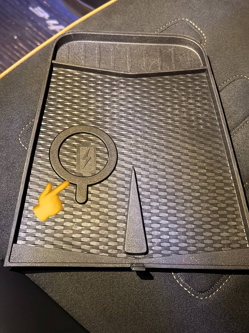

Image pinched off a Google search to save me having to go outside as the weather is bleak here.
It looks like the pad design was ‘fixed’ (read altered) at some point, and that the ford ‘engineers’ couldn’t find a suitable solution to the alignment or camera bump. Well done for showing them up.
Can I ask if your arrangement of magnets is just on the upside of the OEM charging mat, and also if this raises the phone high enough to compensate for the camera bump? My concern was the distance from the charging coil as the charging mat, magnets, camera bump, and case all add up. What did you use for the cover to make it look tidy?
Thanks
I just stuck mine here as a guess and it worked on wifey’s ’phone…….
Ace, that seems like the obvious location. I have Ford applying my updates, including the wireless charger update, next week and so I’ll give it a try afterwards.
